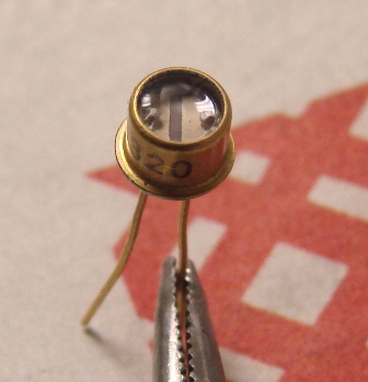

Is this what you had in mind for a hermetically sealed photocell? I haven't seen any like that on the market for years. Though I have a few. You would still need to weatherproof the leads. From a quick look at the ceramic base ones from Digikey, all have a plastic coating, with epoxy coating on the leads.

That is what I was thinking of. What I want to do is sense light, obviously, that I will feed it into a schmitt trigger/comparator arrangement. I don't know if you've been following **broken link removed** other thread I posted on a temperature comparator circuit but I plan to create a light controlled output using the same method as the temp controlled one. The sensor will be mounted outside so it will need to be weather proofed. I thought that these hermetically sealed LDRs would be perfect for that purpose but I'm open to suggestions if you think something else would be more suitable, cheaper, and/or readily available. Thanks.

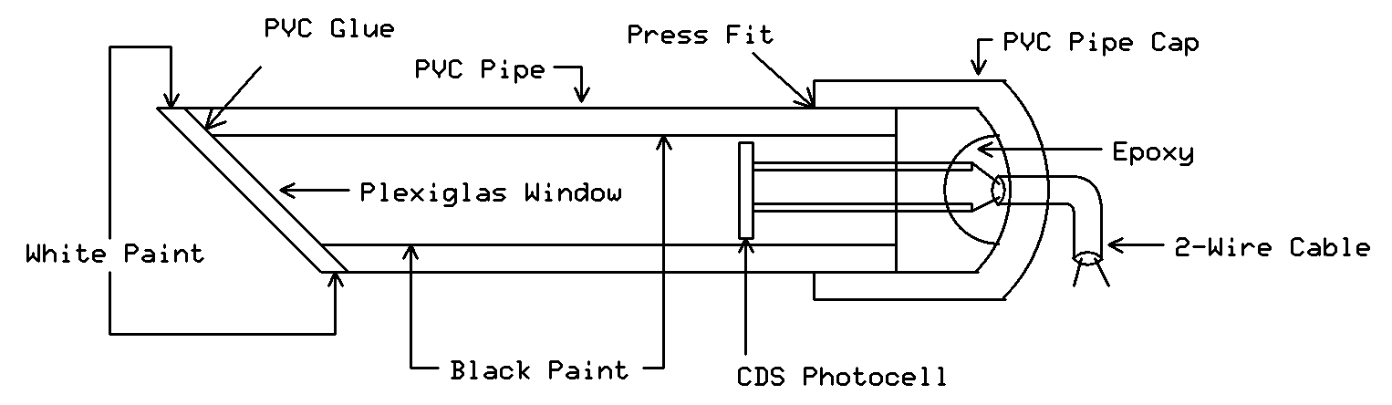

This is what I'd do for a daylight sensor...if that's what you plan. Cheap and pretty easy. The Plexiglas window is to keep the critters out. The slanted end is to keep the opening clear in rainy and snowy conditions. The photocell and cable are mounted in the end cap. Pressing the cap onto the pipe should be enough to keep it waterproof, but removable. I would also paint the edges of the window to make them opaque This is so light, perpendicular to the tube, doesn't reflect off the window's interior surfaces and into the tube.

Thanks for the idea Ken, it looks very doable.
