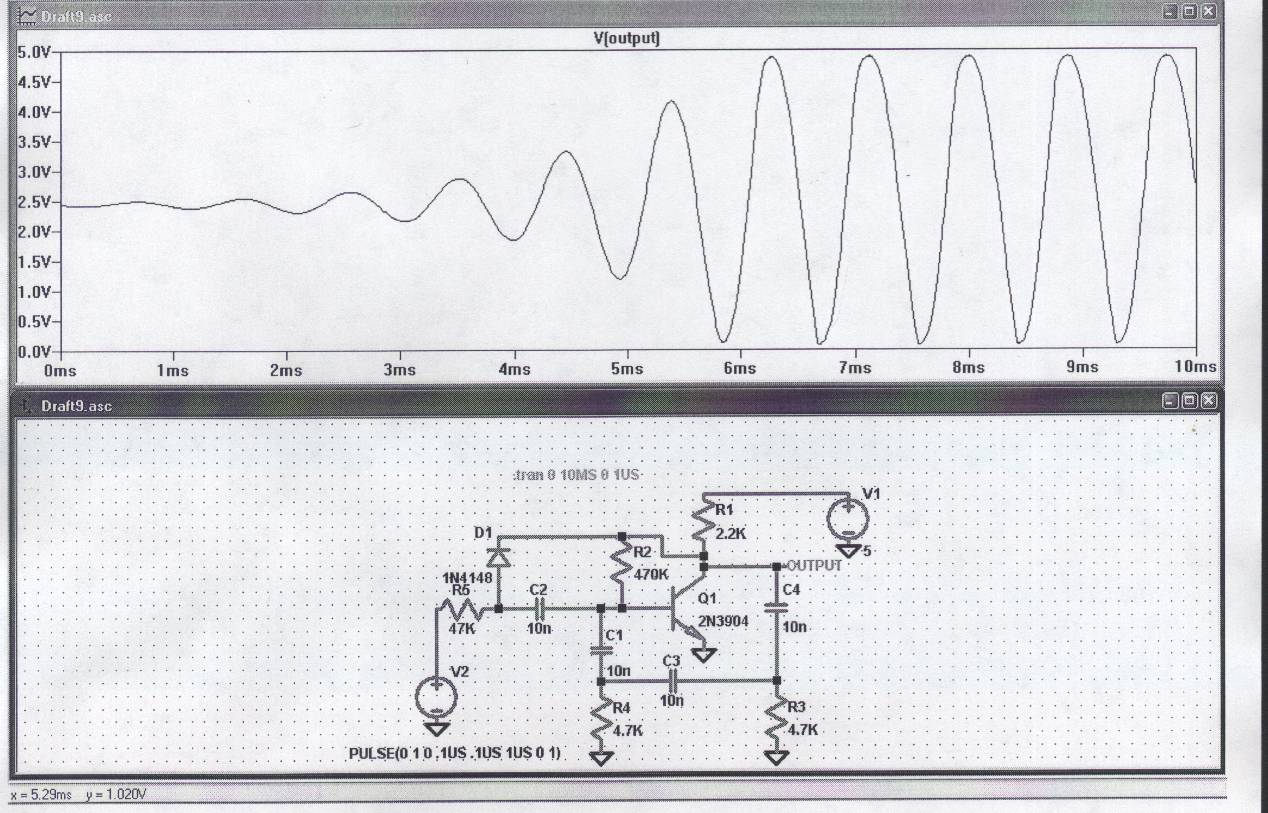

Since my last question didnt get the answer I was looking for, I shall ask this:
How do I make a 1 transistor (BJT) oscillator which makes a sound under bright light and no output under darkness? I have an LDR which can detect light. Once again, I dont want to use IC's.

Hi MS,
Here's a gated oscillator for you to connect your LDR to its gating input and the positive supply, and a resistor from its gating input to ground.
I think it will stop when the LDR is in the light. Reverse the LDR and resistor.
I'll try that one. thanks
I didn't think that circuit would produce a sinewave, so I simulated it. Damn, it works!
V2 is a single pulse to get the oscillator started because simulators don't have noise that starts real world oscillators.
V2 being zero does not stop the oscillator, however.

Hi Russ,
Yeah, that oscillator takes a while to "get up to speed".
Like I said, I think the author got the control input function backwards, a high stops it.
It worked for me, but I had to play with the values of the capacitors and resistors.
