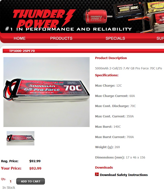

I know that generally we need 10% current if battery's capacity (Ah) is 100.
I think you are talking about an old fashioned lead-acid or Ni-Cad battery.
The modern Lithium-Polymer (Li-Po) batteries that power my electric radio-controlled model airplanes produce an output current of up to 70 times their capacity rating and can be charged at 12 times their capacity rating.
I forgot to read the title of this thread.
I have NEVER used an old-fashioned lead-acid battery except to start my car engine.
