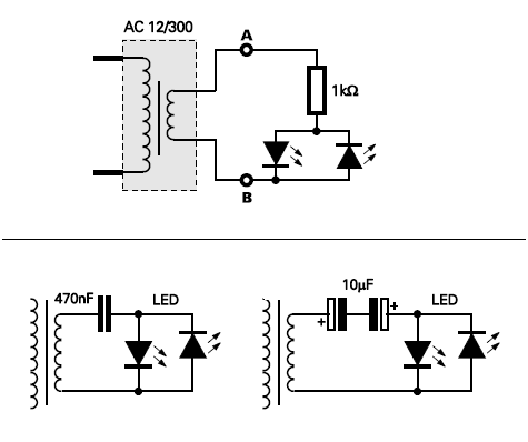

But you can easily buy a step-down transformer.
Or AC to AC power supply
And then you can make experiments with AC.

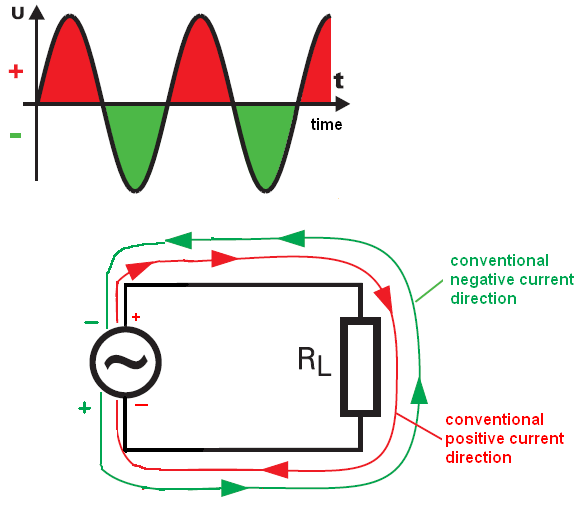

For example you can check that capacitor act like resistors in AC circuits.
And there is no "plus" or "minus" in AC signal.
