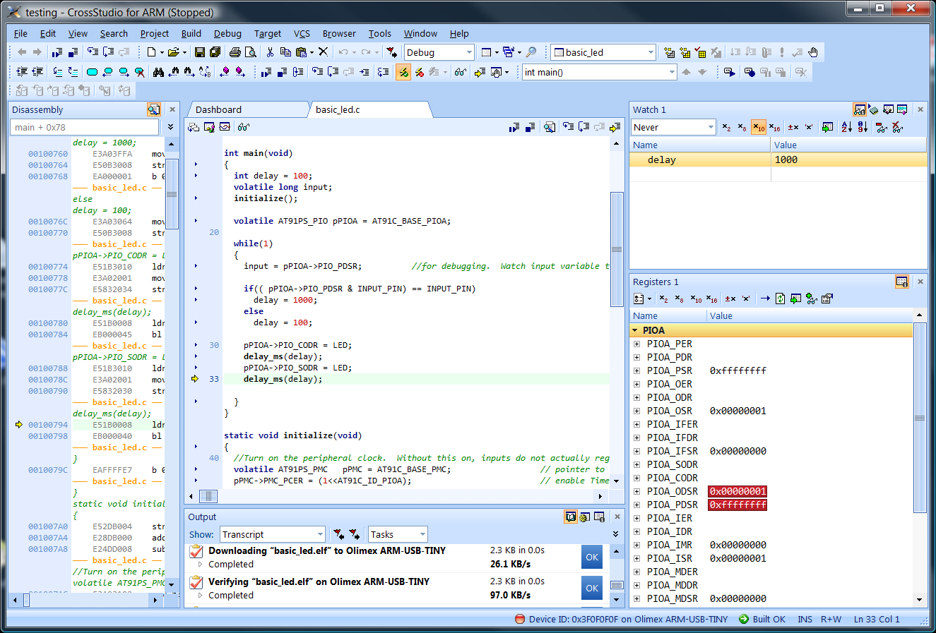

I don't use IAR, so I can't answer any debugging questions with it. In Crossworks, you can view memory and registers in a watch window.
Again, I don't use IAR, so I'm no help with the breakpoint/JTAG issues you are getting with it, either.
I'll compile and load the program again tonight to make sure I haven't made any silly errors, but it should work as is.
I've just downloaded Crossworks compiler. I will see how I get on with this!
Slowly sticking my hair back in again..:confused: (smiley with tufts of hair)

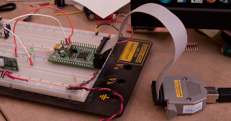

It's working fine for me. Here's the final code, but I think it's the same as the code above:
Hi Mark
I really appreciate this. I have just downloaded the crossworks compiler and got the license code. All will go quiet over the next couple of days while I get my head around this.
I posted a note on the AT91.com forum and I got the answer back suggesting I start with one of the worked examples, which I am convinced import far too many files to simply flash an LED.
I will have a go with Rowley and see what this throws up...
Thanks once again and you did not have to photograph the LED working - I believed you! The screenshot of your register settings was most helpful though!
Simon
