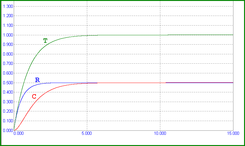

Here is a graph of the energies during the process of charging a cap through a resistor powered by a voltage source.
The green trace is the total energy delivered by the source, the blue trace is the energy absorbed by the resistor, and the red trace is the energy stored in the cap.
It's plain to see that after a long time relative to the time constant (which is 1 here) we see the total energy is 1, and half the energy gets dissipated in the resistor and the other half stored in the capacitor. Thus, the power source put out 1 unit of energy while the capacitor stored only half of that.
The waveforms themselves are relative to the time constant in that if you decrease R the same waveforms occur just that it happens faster, and that does not change the energy balance.
This problem is part of what limits the processor speed in modern CPU's. The resistance causes heat and with each gate charge occuring faster and faster more total heat is generated in the same amount of area, so that area gets hotter and hotter. Eventually there's no heat sink that can dissipate all that heat with the required small area so it can not be clocked any faster.
If we could charge a capacitor and not lose any power, we could clock at much faster rates. It is true that this would take more current, but we would then only be left with the simple problem of increasing the power supply capability.
In theory a capacitor can be charged in zero time with an infinite current, but that doesnt exist in nature. In fact, many circuit analysis programs will generate an error message if a DC voltage source is connected directly across a capacitor unless it has some small default resistance value it uses in series with all caps when there is none drawn in the circuit schematic.
