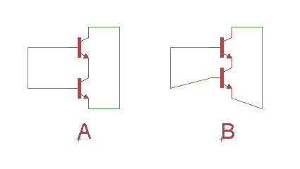

In this Eagle example, "A" gives no error, "B" gives a non-junction error ("overlap").
If you pull the transistors in A apart, there is a net between the emitter and collector that was formed (but invisible to the user) when the two pins were positioned to touch. In B, the pins were intentionally overlapped and no implied connection was made. Diptrace is widely used and liked. I am surprised it does not have a similar functionality. Were all pertinent layers visible when you did the schematic? Are you sure it was not an overlap problem?
Sorry if my questions/advice is well off target. I am just assuming that such a function should be common.

All layers were visible. All connections between components resulted in two errors in the error list; one for each component. The error was something about "no connections". The errors disappeared when I separated them a bit and connected the pins with the wire tool. I may have made a mistake prior to that (I had been using DipTrace for all of 30 minutes), but don't know what/how.
I could not find an online demo, and as much as I would like to help, I don't plan to install DipTrace. There is no additional setting needed in Eagle to get the automatic connection. There is a difference in Eagle between the "wire" and "net" commands. Generally, the net is preferred for connecting components; although, that would have no effect on my results here, as I am using the "move" command to try to duplicate the problem.

What is your grid setting? It just occurred to me that if I were using a very fine grid setting in Eagle, I could get an overlap (non-junction) that would look like a touch. My typical grid is 0.1", so any overlap is really obvious to the user.
