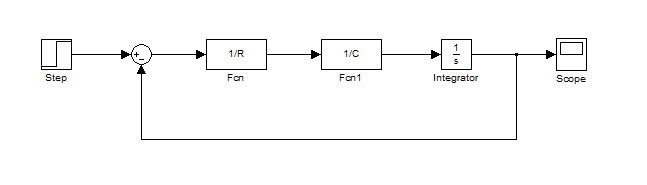

I'm working on my first Simulink model of series RC circuit. I hope that the modelling is okay but I'm getting the following error.
"Warning: Using a default value of 0.2 for maximum step size. The simulation step size will be equal to or less than this value. You can disable this diagnostic by setting 'Automatic solver parameter selection' diagnostic to 'none' in the Diagnostics page of the configuration parameters dialog"
I had initialized R=5 and C=500*10^-6 in Matlab. I have attached Simulink model for RC circuit. Could you please guide me? Thanks.

That is not an error, but just a warning.
I recommend that you go into the "model configuration parameters" menu. Set the solver to "fixed step" and "ode4". This will use the Runge-Kutty fixed step-size method of solving. This is not the fastest solver, but I find it works well and is less likely to give you problems. You also want to set the step size. I prefer to set it manually, and you can set it to 1e-6 to start, and modify from there. The step size should be much smaller than the time constant.

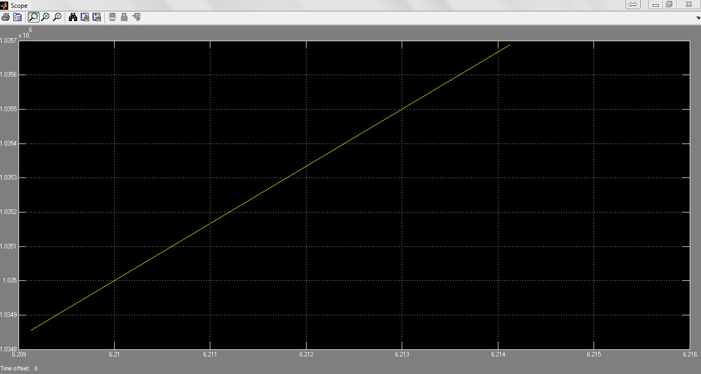

The model represents RC circuit and the step function represents a fixed DC voltage source. Here is the screenshot of the scope and sadly it doesn't make any sense to me. The maximum voltage should not go above the rated value of step function. The final value for step function is '3' and I presume that it can be taken to be maximum value for voltage. I have also attached the working model. Kindly help me with this. Thanks.
Regards
PG
  • rc_ckt_updated.rar
PG,
I see a very big mistake you made in that model. I'm sorry I didn't notice it before, but you are using the FCN block incorrectly.
First of all, instead of a function block, you should use a gain block for the 1/R and 1/C multiplications. That is more straightforward, and I just automatically assumed that that's what you did.
If you prefer to use the FNC blocks, it is certainly no problem, but then you need to change the formulas to u(1)/R and u(1)/C inside. This is because this block is a general arbitrary function block and you can have any number of inputs. In this case you have 1 input to each block, but that input is labeled as u(1).
Another thing you can do is to change the settings in the scope. If you double click on the scope, you will open the plot window. Then in the upper left corner there is a little icon that looks like a gear. It is next to the printer icon. Click on that icon and then go to the history tab and unclick the "Limit data points to the last 5000".
This is why your plot does not start at zero, because only the last 5000 points are being shown in the plot. Typically you want the entire time range in your plot. However, this might overuse your memory, and if it does, you can use the "decimation" parameter on the General tab. If you change this from 1 to 10 or 100 or 1000, then only every 10th 100th or 1000th point will be plotted. Be careful though because decimation can cause you to miss key aspects of the plot if it is changing rapidly.

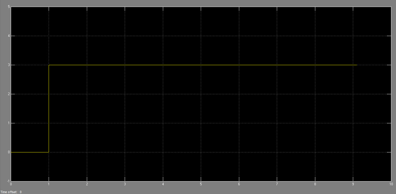

It works now. Attached is the working model. I have used R=5 and C=6*10^-6. Here is the screenshot of the scope.

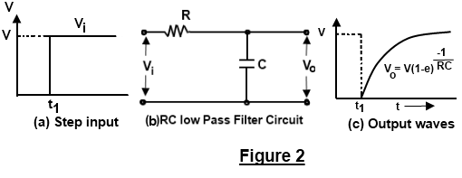

Q1:
You can see in the screenshot that the output is a step function but this is not how the output of an RC circuit looks like. This picture shows the output of an RC circuit in response to step input.

Q1:
LOL Your time constant is RC= 30 us, and you ran your simulation from 0 to 10 seconds. Obviously you are not going to se the exponential shape on that time scale. Zoom in the time axis to 1.0000 seconds to 1.0002 seconds and you will see it. Or, you can run the simulation from 0 to 0.0003 seconds an start you input step function at 0.0001 seconds rather than at 1 second.
