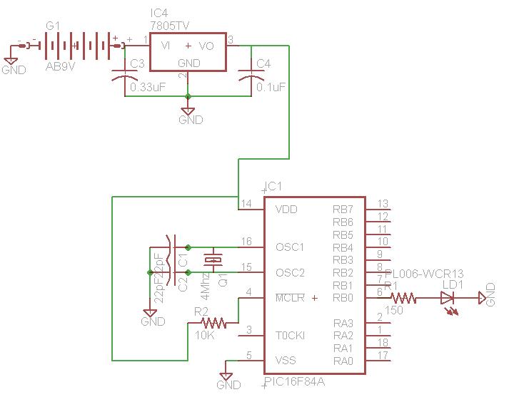

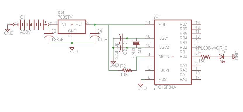

Hello everyne,
I started learning PIC for one semester now on my own and the main help was offcourse from this forum. I then moved into learning electrical software that will help me ask better in this forum i selected EAGLE.
Here the thing,
I have this drawing that i used EAGLE software to draw i have 2 questions if you can help me with in eagle software.
Q1> First, I want to move group of object togather from one place to another see attachment for clarification?
Q2> If you have any suggestion on how can i improve the drawing i already did please let me now?
Thanks in advance

Its better if you can move to Eagle5.
How to move a group?
You just select the components by using the Group tool by dragging them.After select the Move tool & right click on the schematic & select Move:Group & move the cursor & place where you want to place.
To Improve your drawing you must use that Junctions using the Junction tool.This is very useful when doing a schematic capture from your drawing.So it will confirm whether it is connecting or not.
Thanks gayan for replying,
What you mean eagle5 i am using eagle 5.1.0 is that what you meant or another program please specify a website if you don't mind so i can download it or buy the software.
Group move is amazing i could move them and my drawing become more neat.
Right now i am learning more about junction ...
Q> My question is in the datasheet of 16F84A the MCLR is connected to resistor, capacitor and diodes as shown in page 28 is connecting MCLR to 10k resistor is enough or i should do the extra requirements (capacitor and diodes).
Only resistor will be fine.
If you start using a modern PIC like PIC 16F628A or PIC 16F88 you can leave open the MCLR pin & no need any connection to that pin.You can use that pin as an INPUT pin.

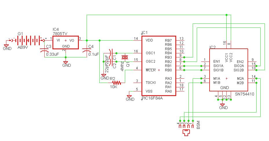

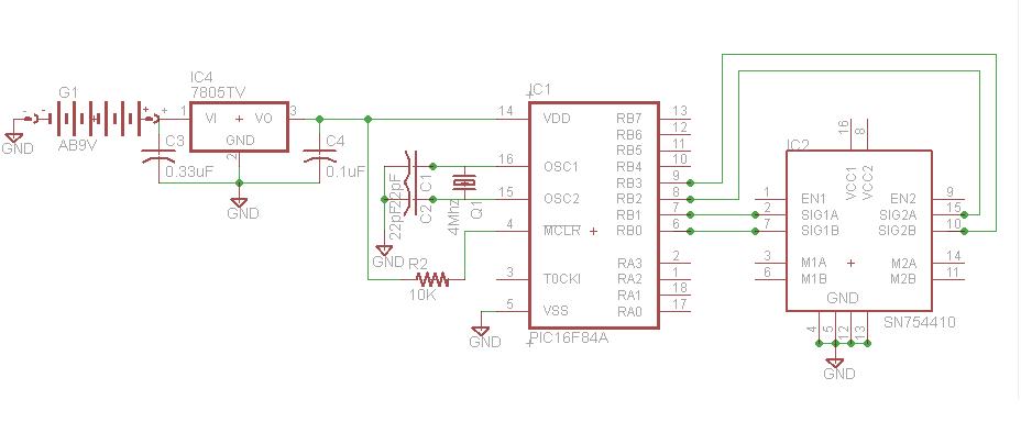

My goal is to control a bipolar stepper motor using sn754410 and pic16F84A
Here are two questions i need help with
Q1> How to draw a bipolar stepper motor using eagle or is there a liberay file with bipolar stepper motor because i couldn't find it?
Q2> The first pin in sn754410 need a PWM and i am using PIC16F84A i am not sure how can i get PWM from this PIC? any idea i apreciate it.
You don't need PWM, it is only for speed control usually which you can do by changing the step length.
I am still trying to draw a bipolar stepper motor using eagle but nothing yet, therefore i decided to focus on my next problem which is
Q1> How to program a bipolar stepper motor using 16F84A i am using the diagram shown below not yet finish but still working on it?
I mean do i send high B0 high B1 high B2 high B3 or there is a true table for it?
Q2> How diode are connected to a stepper motor coils?

THanks 3V0,
I connected the circuit for stepper motor and i am using this codes nothing worked!

The logic of the codes are simple every 1/8s i do this for portB 0 1 2 3 i do HLHL, 1/8delay LHHL 1/8s delay, LHLH, 1/8s delay HLLH then repeat!
Is my codes wrong or maybe the wiring i will try posting the schematic when i finish drawing it for the mean time can some tell me if the codes are wrong.
I am using bipolar stepper motor
Thanks in advance

Here is it the diagram the i am following, Note that BSM in the diagram refer to bipolar stepper motor i couldn't draw all the stepper motor therefore i used 3v0 advice.
I am desperately trying to get this stepper motor moving before 19/July/08 :(
Thanks in advance

You change your OSC setting to XT in the config part in your program.
Replace the below code into the main routine & see.
main	movlw	b'00000001'
	movwf	PORTB
	call	Delay8ofsec
	movlw	b'00000010'
	movwf	PORTB
	call	Delay8ofsec
	movlw	b'00000100'
	movwf	PORTB
	call	Delay8ofsec
	movlw	b'00001000'
	movwf	PORTB
	call	Delay8ofsec
	movlw	b'00000000'
	movwf	PORTB
	goto	main
WoW, it started moving but goving crazy back and forth i think i need to spend time on the codes :) Thanks gayan alot
