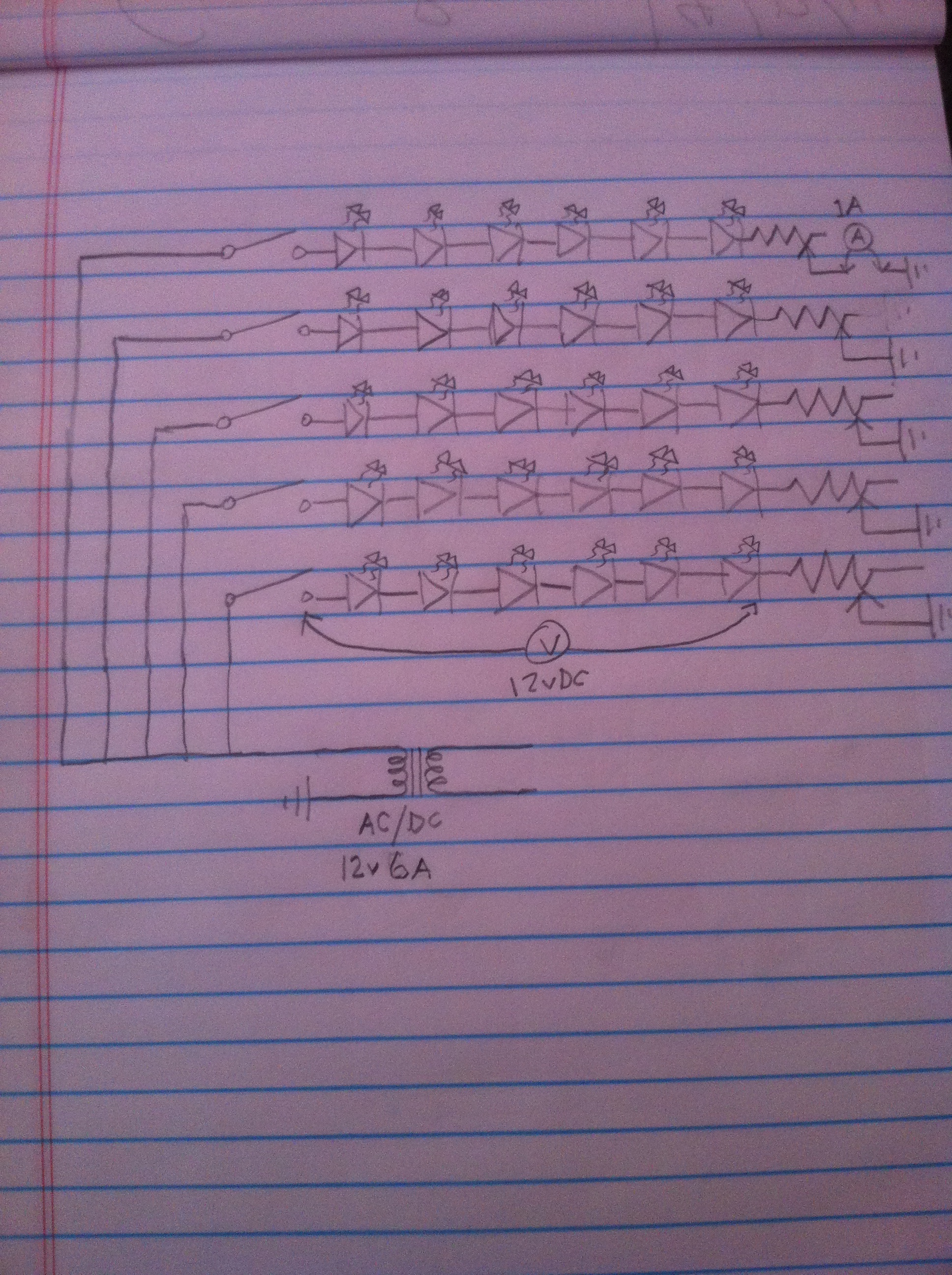

Im pursuing a homemade photography LED array. Ideally, the LED array will be 6 series 5 parallel. (24 volts @ 1000mA per row). Each LED row is a different wavelength, together they make up the whole spectrum. Each LED row I want to have adjustable so you can adjust the color temperature and enhance the photo. They do already exist but there not very powerful, besides I wanna make one for fun. But I ran into a problem with figuring out how to dim them. Potentiometers in series with each array will burn up to much electricity. I'm still learning how to draw schematics. Will this work at all?

From your schematic it looks like you have AC going to your LEDs. You need DC. You might want to share your LED types as different LEDs have different voltage drops, so to make sure we need to know this. If they are really 1 amp LEDs the pot is probably not the best option because of the power.
I figured I would need some sort of voltage or current regulator... I'm proficient in soldering, is there a schematic I can follow and make my own? All the LED's fV is 3.6 @ 1A. (ive stressed them to 4v with no problem if heatsinked).

1. Yes, you could do what you have sketched, replacing the rheostats with adjustable voltage regulators (LM317-type thingies). However, as was pointed out in the other thread referenced above, you're going to end up wasting a lot of power as heat. So ...

Go for adjustable currents. You do not get a great deal of heat dissipated, because the LED voltage does not change a lot. This is completely different from dimming incandescent lights, where the voltage changes a lot and the current changes less when they are dimmed.

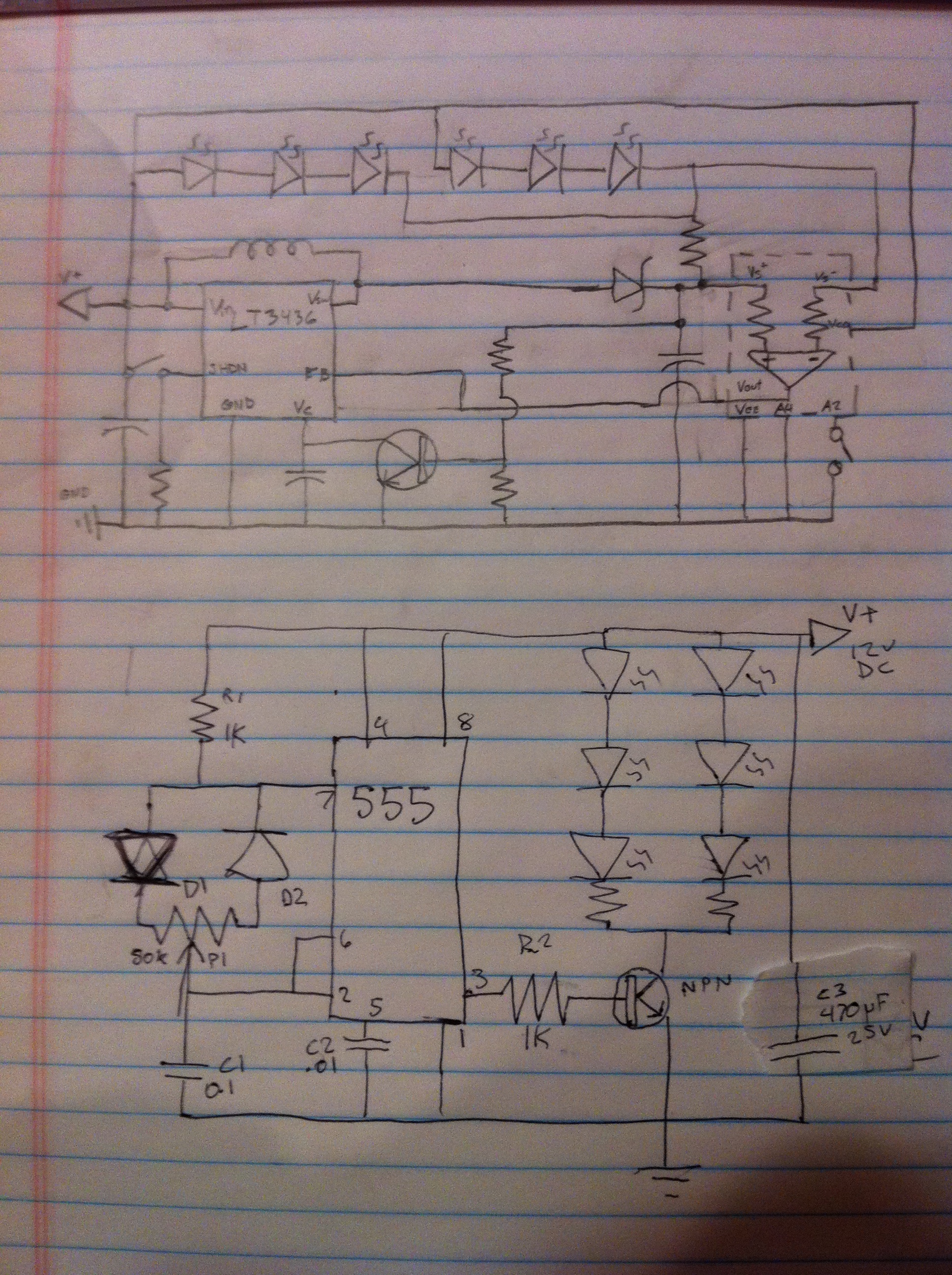

I have redrew these two beautiful schematics provided from Diver300 and Carbonzit, thanks.
Witch of these two would be most ideal? (Each LED can take 4.0V @1A)

That wasn't the circuit that I was thinking of.
I suggested the one that does not switch on and off, but it keeps the current steady. It is at https://www.linear.com/ad/19-current_control.pdf and it is the bottom right of page 3, and it is called "1A Voltage-Controlled Current Sink".
You should not put the strings in parallel. The best idea for LEDs that can take 1A is to have the control circuit exactly as shown for each string of 3 LEDs.
Whatever circuit you use, 12 V for 3 LEDs in series might be too low. The LEDs are rated at 1A, and the maximum forward voltage at 1A is 4 V. You need 1 V drop across the 1 ohm resistor, and something across the MOSFET. However, you may well find that the LEDs only need 3.5 V so you could be OK. Otherwise, increase the supply voltage or have three strings of two LEDs.
