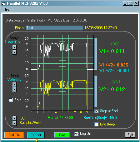

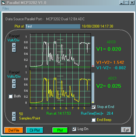

Hi Mike,
I ran some tests a few days ago using a MCP3302 on the PC's parallel port.
Repeated for this post.
Used a standard RED LED, the voltage scaling is a true representation of the LED Vout, no opa.
Light source small hand torch [lamp]
It shows on both traces on my analog logger.
Thought you may be interested.
Regard
Eric.
Hi Eric,
Thanks for info'. Looks very nice on your analog logger.
Mike
