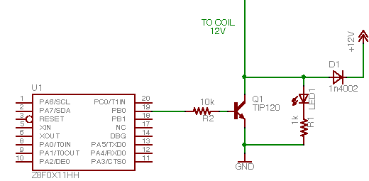

Looks like the led is in series with the coil..I believe the led will stay lit all the time, dim with output low and bright with output high..
Oops. I made that incorrectly. I'll update the schematic. I have it here on a breadboard, I just copied it down wrong.
EDIT: updated.
Is the Diode in the right place, or should it be on the other side of the LED, or does it matter?

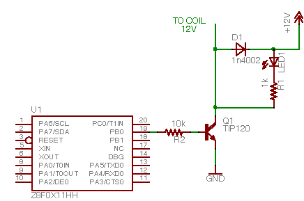

I always connect the indicator LED seriel with relay coil. If the desired current of LED e.g. 10mA, relay coil suck 50mA, need a shunt: LED voltage/40mA, about 47ohm.
What's the advantage to this method?
When I try it that way, it looks like the LED sucks 2 volts out of my 12volt power to activate the coil. It still works, but the coil needs at least 8 volts to activate. It gives me less leeway, and I'd like this to operate even if the 12v supply gets very low.
I can hear that the coil doesn't activate as stongly as it used to. I'm also worried, because the relay will see alot of vibration, if it's not held firm it may uncouple.
If this just helps reduce current consumption I'll do it the other way. Current saving isn't a priority.

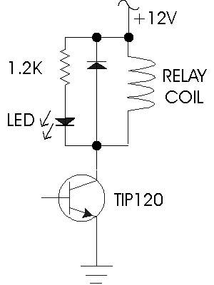

LED as a resistor
The schematic of what I meant with the diode in parallel with the relay coil is the first drawing. The second drawing is simpler, and as long as there
is + 12 volts where the TIP120 is it should work also, and the relay can
be in another location without running an extra wire back to the LED circuit.
DirtyLude is correct, It is not a good idea to put the LED in series with the relay coil as it will drop the voltage about 2 volts, and if the LED current is lower that the relay current an additional resistor would be needed to drop the 2 volts at the relay coil current.

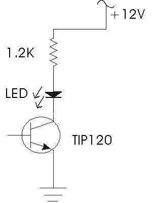

LED as a resistor
Led on indicator without relay
