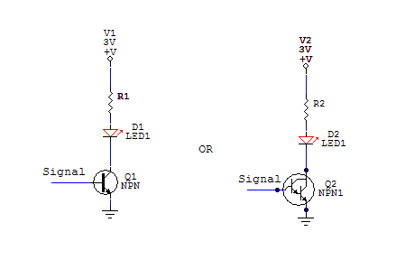

My idea: Just take the signal and use it to turn on an LED using an NPN Transistor. Led's don't even need 3V I don't think so it "should" work. Then you could have a variable pot to control the input (illumination point) and another for the brightness of the led.
I'm unclear as to how this would work. If I could be pointed to simple schematic that would be great. The LED requires 2V minimum and the best I can tell is the maximum voltage of the signal to the driver is about 5.5mV.
Ok here is the basis of my idea...although I forgot the potentiometer for after the signal.
The second one is a Darlington in case there wasn't enough amplification...but I doubt it would be needed.

Thanks. I did manage to figure it out on my own and it works fine with one exception. I used a BC547 and it works great with my test source (an old tape player) but the voltage from the headset must be lower as it needs to be at almost max. out to provide enough base voltage to illuminate the LED.
Is there a more suitable transistor?
