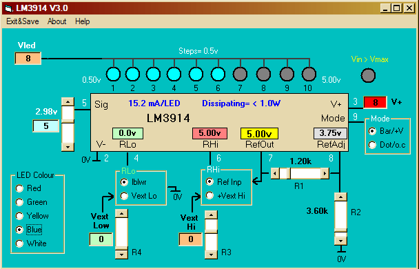

Hey all,
I found these schematics/diagrams in another thread (a year old or so) and wanted to know how do I go about finding out what resistors to use for a 0 ohm/ 90 ohm fuel sender.
This is for an autombile not a motorcyle like the diagrams were inteded and it is using 12v
not 8v like the user wanted.
The other schematic is for a warning indicator that will flash as the fuel level gets near empty.
I need my electronic "wizards" assistance on this.
Thanks.
