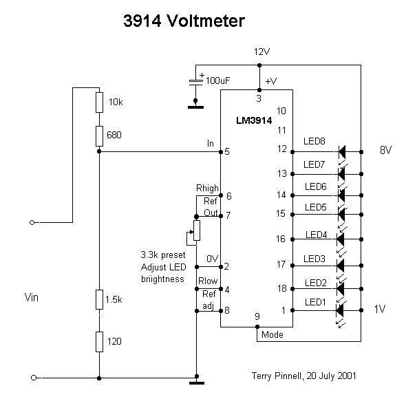

Does anyone know how I might have a row of LEDs that act as a battery indicator (say 5 in a row and if 1 5th of the battery power was gone only 4 LEDs would be lit).

Hey bot dude, what voltage is the battery?
I think this is what you want. ???
the above circuit can be modified to support two variable resistances that allow u to control both the upper as well as the lower limit of voltage to be measured ,refer to the LM3914 datasheeet for the pinouts.
