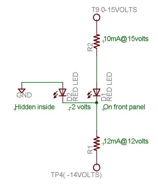

Hi, i am building a dual tracking power supply for 0 to 15vdc and i would like to use 5 LEDS as power on indicators. However, i would like the LED's to get progressively brighter as the voltage goes up. So,
0V = min brightless
15V= Max brightness
If there is a simple electronic method i would like to hear it.
I would like to use a PIC but i am really new to programming.
The way im thinking of doing it is using a PIC16F628 as a volt meter, and have 6 different resistors connected in parallel to the LEDS. When a certain voltage is triggered a different output will turn on and in turn a different brightness.

You want simple way.
15 volts = bright LED.
0 volts = dim LED.
LED 1 is on the front panel.
LED 2 is a "2 volt zener" to make a -2 volt supply.
R1 is to set 12mA.
R2 is to set the 10mA at 15 vots. You will get about 1mA at 1 volts.
Sorry no PIC!

Sorry i guess you guys misunderstood me i have five LEDS that i want to hide behind a knob to give it a glowing effect.
Also one LED lights up at noticeably less brightness is it faulty?
Look at the LM3914. It drives 10 LEDs but can be used with only 5 LEDs. Tie outputs 1-2 together, 3-4, 5-6,7-8, and 9-10.= 5 LEDs
Do you have the LEDs in series so they all share the same current?
Or are they in parallel then each one will have a different current and a different brightness?
