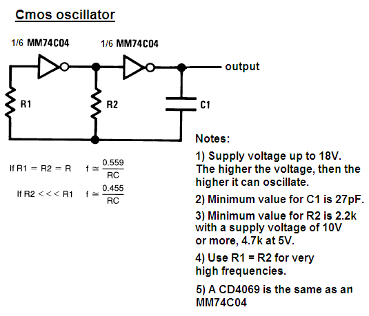

Yes, an ordinary Cmos inverter or gate is an oscillator if two of them are used like this:
The 40106 is a hex Schmitt and will work in this circuit. But connect the inputs of the 2 unused inverters to gnd.
Schmitt Triggers provide hystersis which is necessary for the oscillator function.
I suggest you replace the energy wasting R9 with a 100 nF capacitor to provide some bypassing.
You don't need the 2 inverter oscillator, the single inverter one works well.
