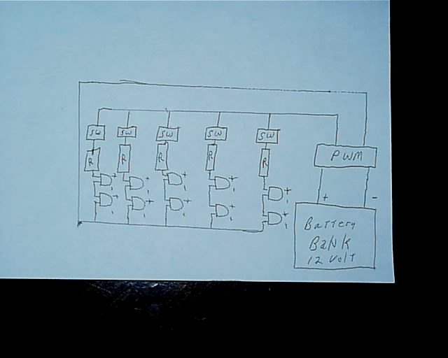

I am new to this site and very new to wiring leds. I have a new home I built and in anticipation of wiring for low voltage led lighting, put a fair amount of cat5e in the walls.
My first large endeavor is to wire undercounter lights and I plan to make my own lighting using 2 luxeon style stars for under each cabinet -- 5 cabinets total. The stars I have are 3 watt, 650 milliamp and have a forward voltage of 3.6 to 4 volts.
If possible, I want to have a rocker style on off switch for each cabinet and a master dimming control using a pwm kit.
To supply the led systems I have a small bank of 12 volt batteries that will be recharged through a solar panel. I also plan to place a voltage regulator prior to the supply of the cat5e in order to limit the maximum voltage.
I plugged info into a resistor calculator which suggested the resistor value for each of the arrays should be between 6.8 and 8.2 ohms but does not suggest a wattage.
I have attached a rough wiring drawing -- please excuse my lack of proper symbols on the drawing.
I would appreciate any thoughts on my rough wiring drawing as well as suggestions for a pwm dimming kit/method as well as suggested wattage for the array resistors. Also, if I am way off base on this and it can not be done with one dimmer, please let me know.

For resistor power rating, using the lower LED voltage drop of 3.6V to get an 8.4V drop across the resistor yields dissipated power at (4.8*4.8)/8.2 - or 2.8W. Always use a resistor that is rated at 2x the power being dissipated - which would be a minimum of a 6W resistor. Looks to me like this is going to be a fairly warm system that may require some heatsinking.
Another thing to think about is the battery bank. I don't know the capacity of the bank, but if the LEDs are left on long enough, you will see a dimming of the light intensity without any type of PWM circuit involved due to the drop in battery voltage. You may want to look into a constant current circuit and also some type of shut off feature that kills power to the LEDs of the battery bank voltage gets too low.

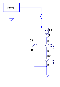

Why not use a switched mode power supply rather than all those resistors?

Building an SMPS isn't hard, if you limit the duty cycle of the PWM to 60% then you could both safely and efficienctly drive the LEDs by adding an inductor and shotky diode.

Thanks for the switched mode power supply suggestion. Are you speaking about a Buck Puck? And, would I place the dimmer before or after that? Also, since I am speaking of controlling 5 separate arrays and have cat 5e in the walls, I guess I could then use one leg of the cat5e for each of the arrays with the 6th wire for the common ground. Does that make sense as an option. Finally, I do plan to heatsink the components to keep everything from getting too warm.
Joe H
Yes, you could use a Buck Puck which is a kind of ready built switched mode power supply.
The circuit I have attached can be used after the PWM dimmer, indeed it won't work without a PWM dimmer. You need to be careful with the duty cycle of the PWM dimmer because it will blow up the LEDs if it's set higher than about 60%.

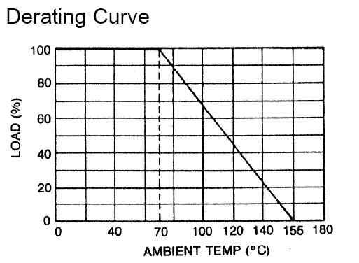

There's no need to derate unless there ambient temperature is higher than the one given for the power rating on the datasheet. Sometimes it's even safe to over rate if it's cold or the duty cycle is low. For example a 3W resistor might be able to take 10W pulses at 30% duty cycle or continiously dissipate 6W at an ambient temperature of -5°C.

No they're not going to cook, if they're rated for 3W, they'll be able to safely dissipate 3W so using 6W resistors would be a waste of money.
The only time you can justifiy using a higher powered resistor is if it's operating at a high temperature.
For example, look the datasheet for some 0.5W resistors, at temperatures up to 70°C they can safey dissipate 0.5W. You only have to derate if the ambient temperature is higher than 70°C.
I couldn't find the derating curve for any 3W resistors but I imagine the temperature in his house is nowhere 70°C so there's no point in using larger resistors than 3W.
