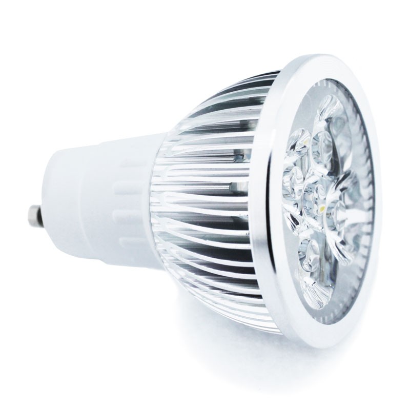

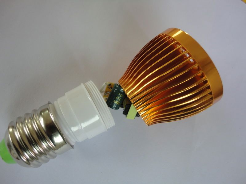

Hello friends.
As Some of you may know I started a thread about LEDs, two or three days ago. When I was searching I noticed that the LED's which are used in home aplications and supplied by 110 or 220V use a circuit inside them, Can you guys plz let me know why that circuit is needed (except of lowering the mains voltage of the LED's). I took one a part and noticed that there is a chip and a coil/choke plus other components
Thanks.

Ronv, exactly... it's simply a SMPS... a switcher to deliver a set current into the LEDs, and the voltage will depend on what the LEDs drop for that current. A very efficient way to power LEDs because all the power goes to them, and you don't have dropping resistors.

Maybe your electricity is 220VAC. An ordinary white LED operates at 20mA and has a forward voltage drop of about 3.2V.
The LED needs DC, not AC so you use a full-wave bridge rectifier and a filter capacitor (to prevent flickering).
The capacitor will have 309.7VDC.
If you use a series current-limiting resistor then its value is (309.7V - 3.2V)/20mA=) 15325 ohms and it will heat with (309.7V - 3.2V) x 20mA= 6.13W.
A huge 10W resistor will be VERY hot.
But if you use a switching LED driver circuit it will be small and will barely get warm.

An LED is a rectifier (Light Emitting Diode), it drops a voltage when you put a current through it. They are rated to give a specific light output per current passing through. Normally, when you light an LED, you have a specific voltage you are driving it from, say 5V or 12V. You have to put a 'dropping' resistor in line with it to limit the current and drop the rest of the voltage. Resistance_value = Source_voltage - LED_voltage / LED_current. This is very inefficient, as most of your power is lost across the resistor. The switching power supply delivers a set current, whatever current your LED is spec'd at, and the voltage will be determined by the LED itself, so there is no other power lost in the circuit, except the regulator circuit, which is in the neighborhood of 95% efficient, as opposed to an Resistor Limited circuit, which would be about 40% (5V source), or 16% (12V into 1 LED) or 33% (12V into 2 LEDs in series).

Because the V-I characteristic of a diode is very steep and heavily depends on temperature and varies a lot between different batches of the same led, meaning that a small variance in voltage will cause large variance in current, and current is ultimately what defines the brightness and what may kill the diode.
The consequence is that say on LED will draw 20mA at 2.5V, but another piece could draw 20mA at 2.4V, now put 2.5V across the second one and the current will rise steeply to say 40mA. Obviously this is not a good idea, so you allways want your source to put current through the diode and not set voltage across the diode.
