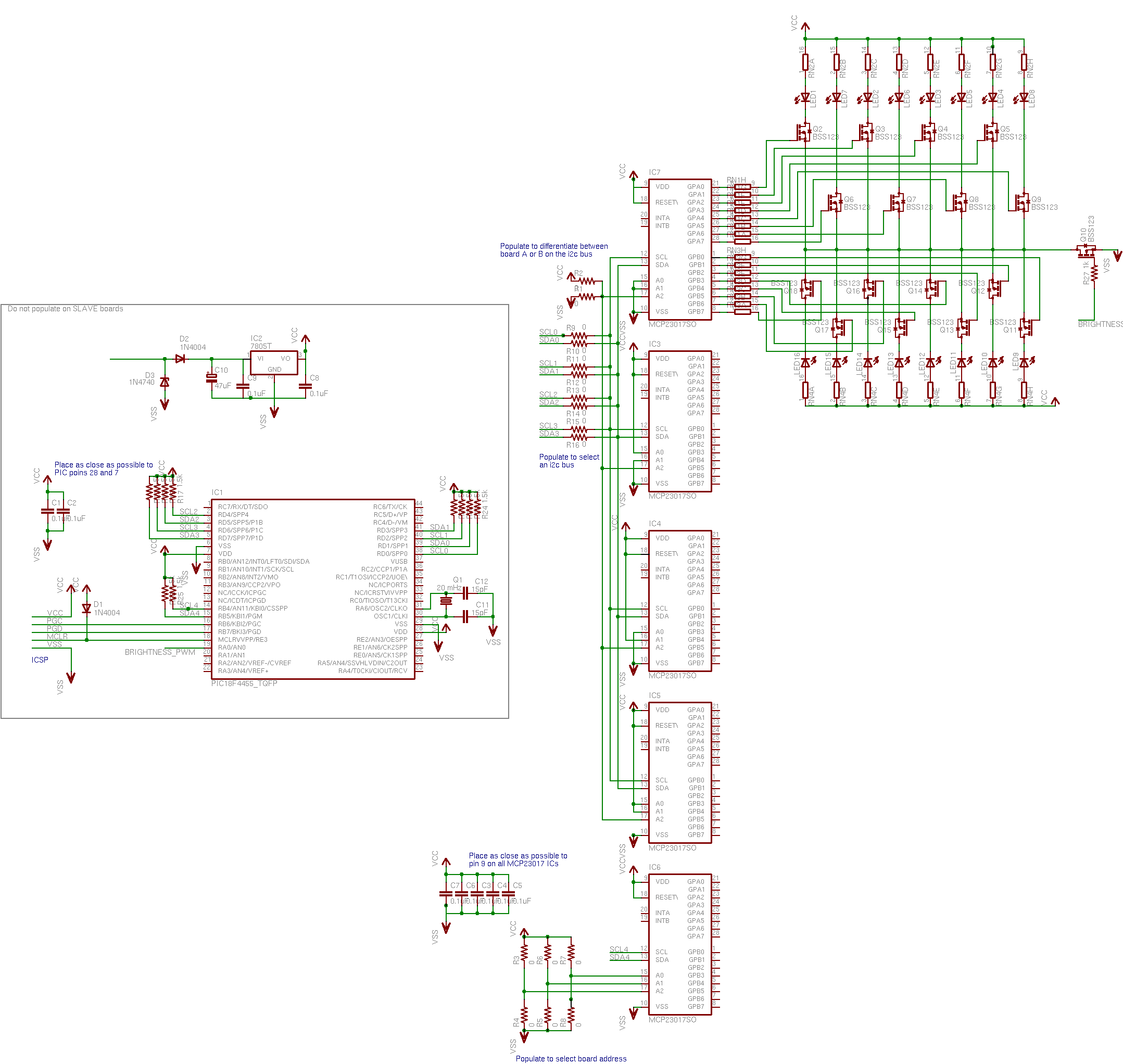

All right, I've got a very preliminary schematic drawn up. The schematic is probably missing quite a few things, but I'd like opinions and/or suggestions.
https://www.stellarcore.com/version1.png
The part that I am mostly unsure about is the big mess of LEDs and nFets in the top right. Once I've got this circuit settled, I'll replicate it for the other three MCP23017s (the fifth MCP23017 is for the IR sensors).
I think the nFet I chose should be good for each individual LED, but I'm not sure if it will be adequate for the BRIGHTNESS_PWM signal. It is rated for 0.68A when pulsed (and if I put 25mA through each of the 16 LEDs that works out to .4A so it should be ok, right?).
I havent chosen values for the resistors yet, but that will come later. Also do you think the resistors between the gates of the FETs and the MCP23017 neccessary? If I could eliminate those resistor networks I think it would simplify my PCB a bit.
Final question: Is there a suitable chip or something that I can get that has a whole bunch of fets in one package? Again, it would really simplify the PCB.
Thanks for your help, and I'm really looking forward to reading what you all have to say.

Do you really need a FET for each LED? That's going to be a lot of FETs!
I would first shop around for your LEDS and experiment with how you want to power them. Choosing LEDs is kinda like buying paint - LEDs from different suppliers are going to look different. Test the LEDs at various currents and with different types of frosted glass to see what will work best. That will give you an idea of what your real power requirements are. If, for example, you can get the drive to each LED down to an average of 8 mA, you won't need the FETs.

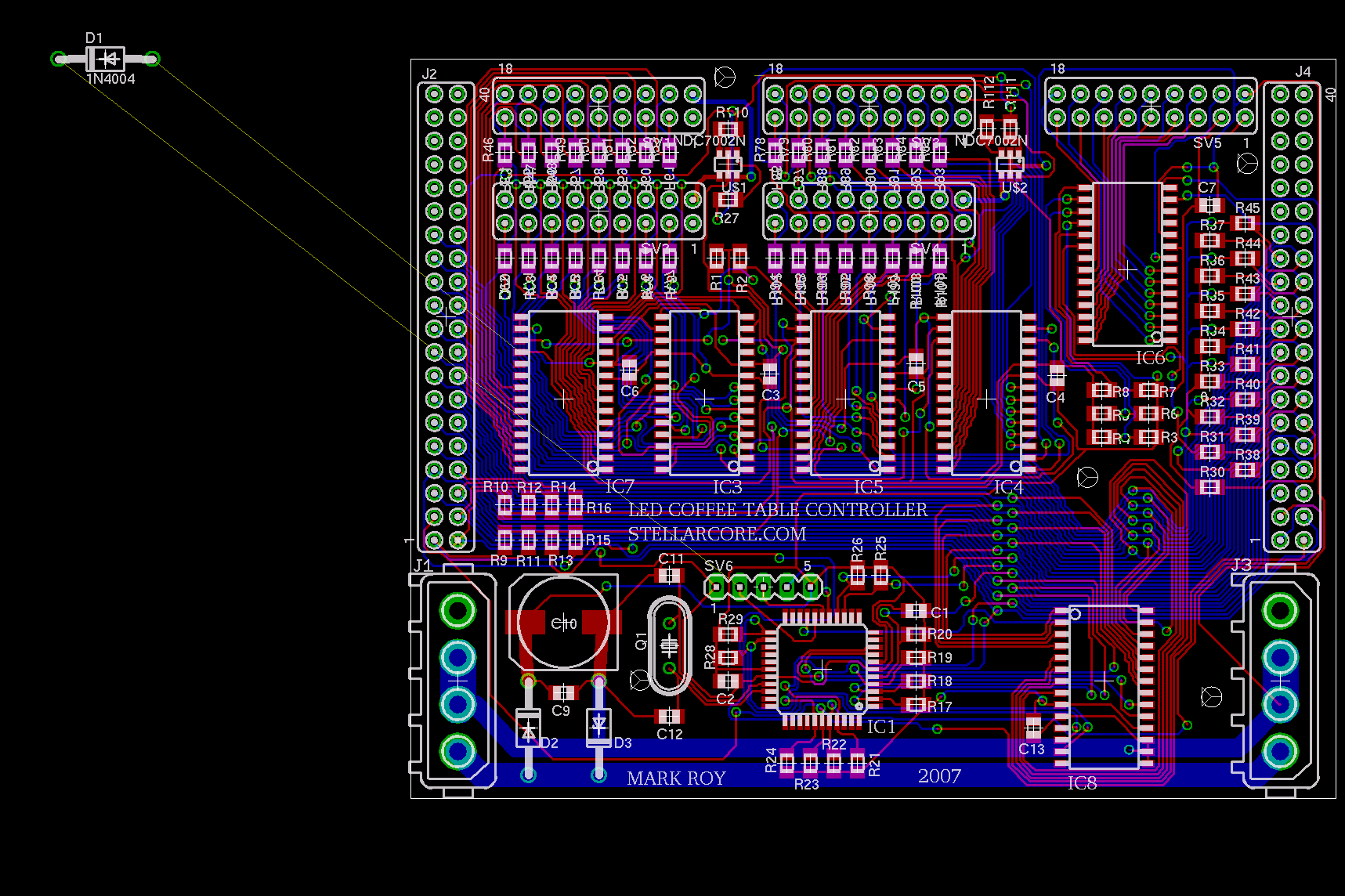

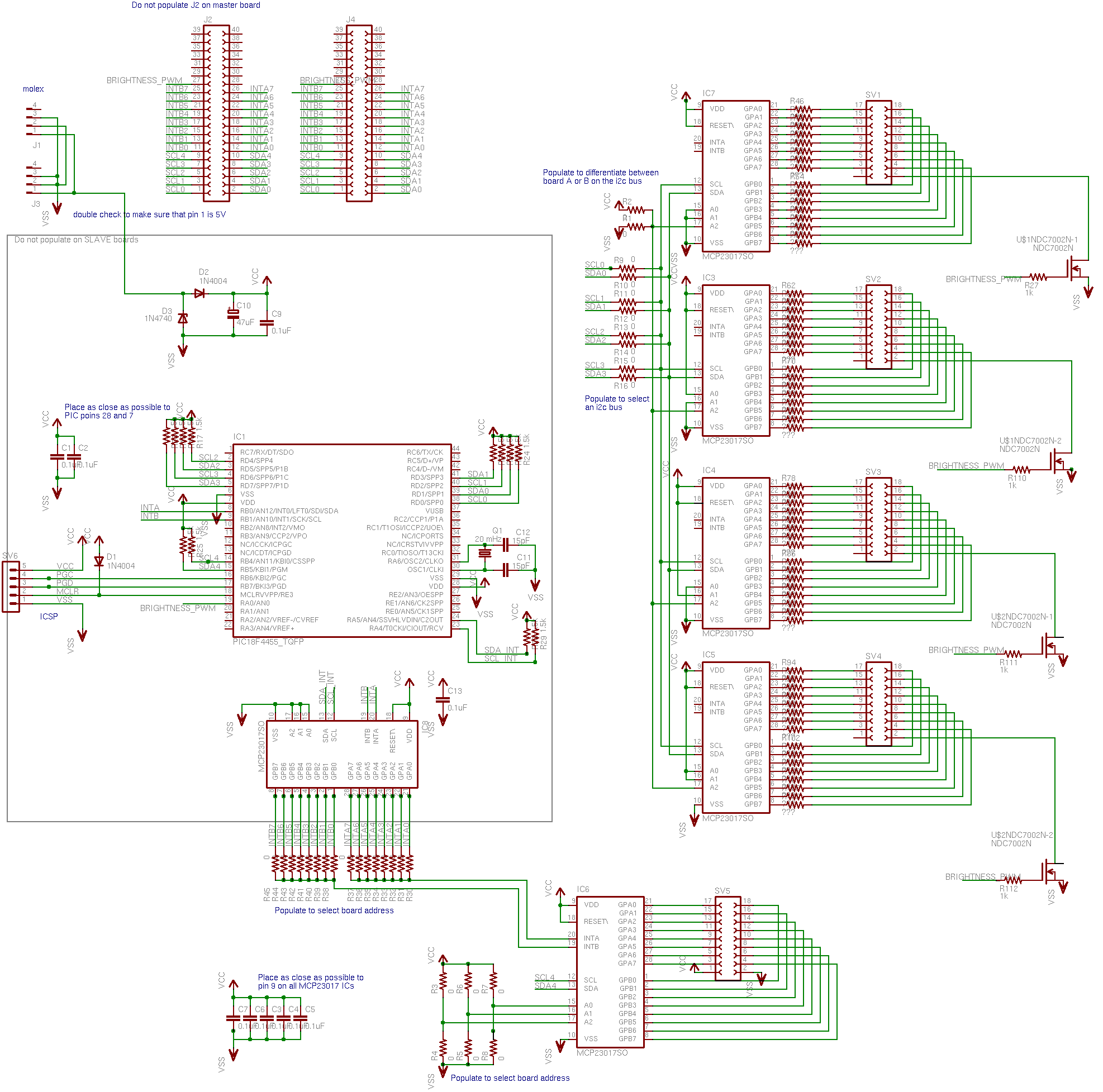

I've made a bit of progress on my LED table project, I thought I would share.
I've purchased some IR diodes and phototransistors from Digikey that I have been playing with. I just received them yesterday, so I'm still trying to work out the best configuration to use with the photo-transistor. The best configuration I've found so far is to connect the emitter to ground and then use a 10k pull-up resistor on the collector. In this configuration, the output voltage swings nicely between ~2volts and ~4 volts. To calibrate the sensors, I place one of the IR LEDs right next to the phototransistor and ever so slightly angle them together such that the photo transistor is just on the threshold where it can be detected by the PIC. Once its setup like this, if I put my finger or any object within about 2 inches above the sensor, enough IR light is reflected to throw it under the voltage threshold (~3V).
As for the IR leds, they seem to work well enough, but they are a bit more power hungry than I had hoped, they are rated at 50mA each. I've been powering one through a 100 ohm 1/4 watt metal film resistor which pulls ~32mA. It seems to be getting quite warm, which has me concerned a bit. I may have to figure something out for this, because the finished table will have 128 of these IR LEDs, each LED/Resistor pair consuming approx 160mW means that I'll be consuming ~20W continuously just from the IR diodes. One possible solution to this could be to supply several voltage sources to the LEDs and switch them off so that only a few of the LEDs are operating during idle time, switching the rest of them on when the first sensor is triggered).
I've also been working on my eagle schematic and board layout while waiting for my parts. I've decided to elminate the mosfets for each individual LED because I think the MCP23016 should be able to handle the current. I plan on using molex power connectors to string power to each of the PCBs and IDE cables to string the interrupt and i2c lines. The PCB still needs a bit more work, I would like to make the power lines a bit thicker (especially the lines that drive the LEDs). Please have a look at the following links and let me know what you guys think:
https://www.stellarcore.com/schematic.png
https://www.stellarcore.com/pcb.png
