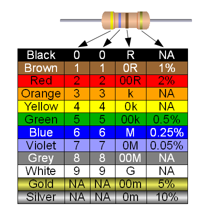

I don't know.. the color of the resistor is Violet, Grey, black black with a gold band for 5%
That's 68R as I mentioned previously.
