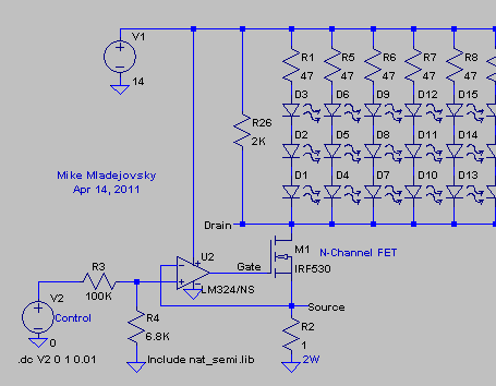

Hi all,
I am building a simple LED dimmer circuit using a STP16NF06 FET. It takes input of 0-10v signal that represents the level of the LED, ie 10v == 100% 0v == 0%. The load circuit is 12v at about 1.5 amps. What I would like to know is whether I need a current limiting resistor on the gate of the FET or is it OK to hook up to the 10v? Any other things I should do to the circuit? Sorry no schematic as yet, but all I am doing is running the 10v + signal to the gate, +12v to the load and the - load to the source, drain to gnd of 12v and 10v.

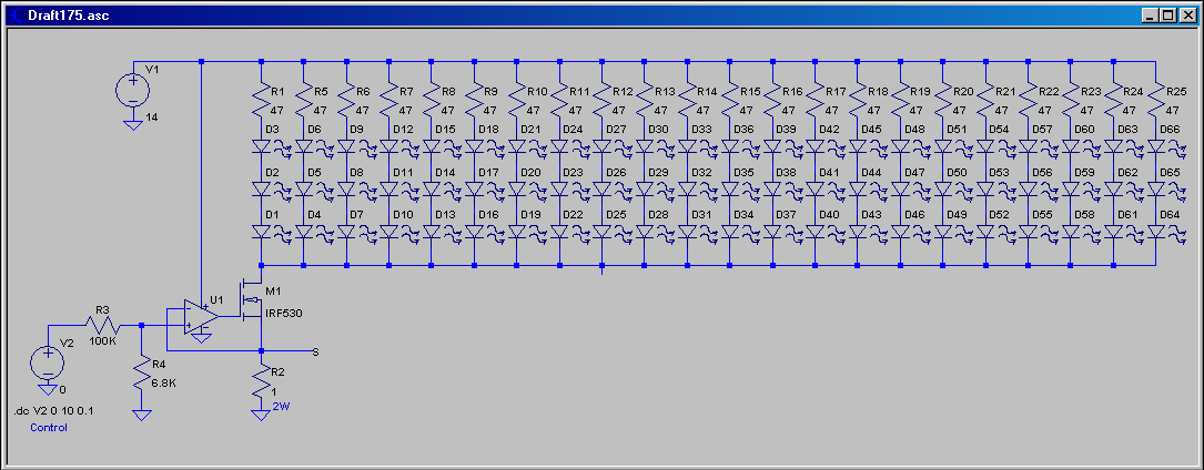

no, simply a parralell array of series arrays of 5mm standard leds with a current limiting resistor. Foward voltage drop of ~3.6v per led arranged 3 in series with a 47ohm resistor, then that in parralell to 22 sets of three leds.
This will do what you asked for:
You want the current through the leds to be proportional to the control voltage. The maximum forward current for your leds is likely less than 30mA, so I set it up to get 27mA when the control voltage is 10V. Bad news: a supply voltage of 12V is not high enough to get sufficient current at 10V control voltage. The supply voltage must be at least 14V. This is a consequence of putting three leds in series with the 47Ω resistor. Two would have worked with only 12V.

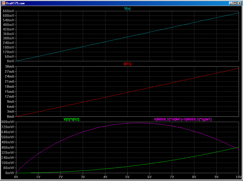

Look at the sim plots: I(R1) red trace is current through one of the parallel branches as the control voltage goes from 0 to 10V. The Fet source voltage is V(s) light blue. The current being regulated by the opamp is proportional to the drop across the 1 Ω source resistance.
Note the Violet trace, which is the power dissipation in the FET. It will need a heatsink. The power dissipation in the 1Ω source resistor R2 is the green trace. It needs to be a 1W resistor( not 2w as shown in the schematic)
The opamp combined with the FET is a voltage to current converter. The Opamp can be a LM324 or LM358, or dozens of others. Your NFET will work in place of the one I simulated.

Ok, I have built a full test system for this, with the full number of leds on it and I have an issue where when the input voltage is 0v there is still enough current in the leds that they are lit. What do I need to change to fix this? I have a feeling that its because the bulk lot of leds I bought have a smaller foward voltage. Is it just the current limiting resistor in series with the three leds I need to change for a higher value?
Is the opamp rail-to-rail output? It is probably not pulling the gate of the FET low enough. An LM358 should work.
LM324 should work fine. Im assuming an enhancement mode NFet. Is yours?

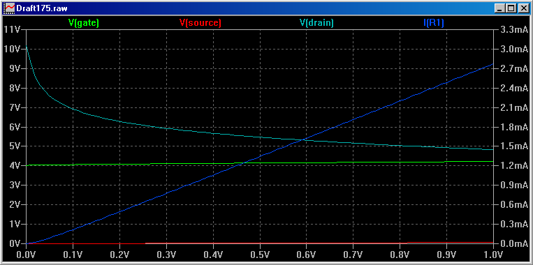

Check that the voltages at Gate, Source, and Drain are similar to these for low input voltages. Note I added R26. See if that fixes it.
