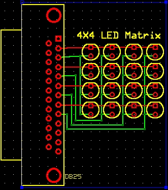

Ok, I just drew this up. It's not quite right though. I gives you the basic idea, but I'm pretty sure you need to add some resistors. I'm not quite sure where and I don't know of what value. Can someone else please tell me where the resistors should go and what value they should be so I can draw them into the schematic for m_ocx?
Also, this schematic is correct (minus the lack of resistors) right?

oh realy thanks
this is exactly what i was looking for,
now about adding more LED's and developing bigger matrix what we have to do ?

Bear in mind that each LED must have a series resistor to limit the current, otherwise you will probably blow both the LED's and the parallel port!.
To add more it gets MUCH more complicated, you have to create a lot more output pins - you can do this by using shift registers - but both the hardware and the software get rapidly more difficult!. The 100x100 design you mentioned would be very complicated (and expensive), and I'm not sure how fast you would be able to multiplex it - too slow and you see the visible flicker.

Yes this is true, that's what I was saying but what should the value be? 330ohms seems like a familiar value...
