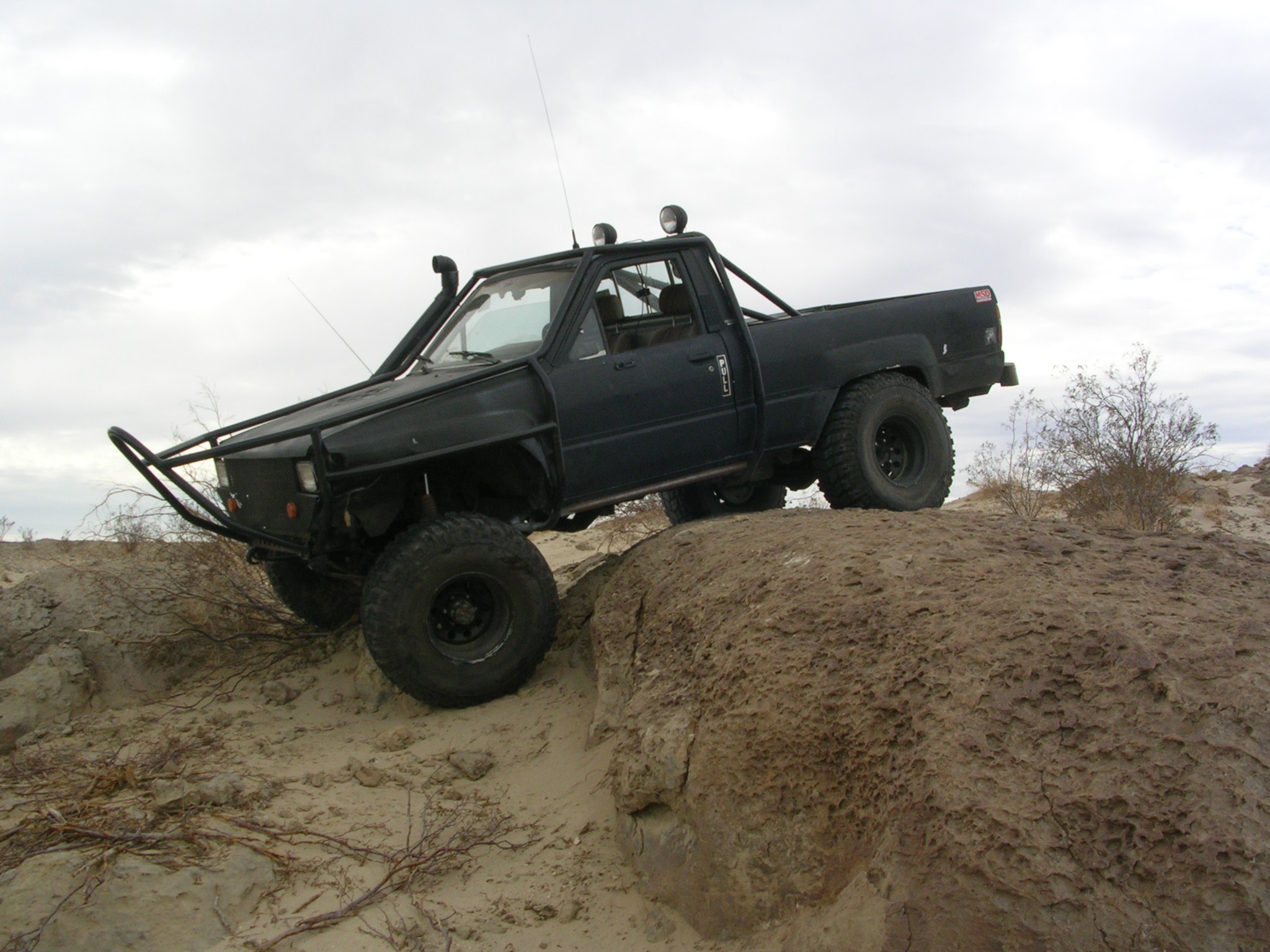

Hey Audio, long time no type! Ya I've got a little project I need some help with. Haven't done a whole lot with electronics in a while. I bought this truck october before last without realizing it was gonna turn into my life for the next year or two:D. I've since found out I'm a pretty okay fabricator and have learned SOOOO much about gears n axles n engines and what not.

Those would work oznog. I'm also very open to using PWM, I would imagine this would be more efficient because of the lack of an inductor...
Those big wheels on your nice truck give it a lot of ground clearance.
You're in California, Zach?
Then the truck is up so high that the lizzards (or Mexicans) can't jump in.
Can you jump in?
Yes I am, and no they don't have a chance hehe. I felt kinda bad the other day, I was supposed to give a ride to a rather hefty woman and she could barely get in my truck.
Here in california there's soooooo many trucks lifted way higher than mine. It's rediculous, but the funny thing is they have zero offroading capability, all for show.
How's everything goin up there in Canada?

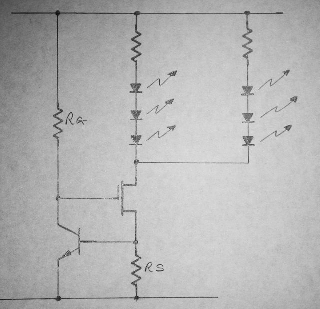

Hiya Zach,
Log time no hear mate :rolleyes: anyway over here in our RE world a bloke came up with such a simple circuit for powering led's correctly for the component count it's hard to believe how well it works. Personally I've made a high brightness led light using 2 strings of 4 high brightness led's (825,000mcd) and I've tested the circuit on my 30 volt benchtop power supply. The Rs resistor is what sets the current and the Rg resistor isnt critical I just used a 1 meg resistor. My circuit outputs 95mA which is 5mA below the maximum spec's. As the forward voltage on the led's are 3.5 volts so for 4 in a string any voltage under about 13.5-14 volts tends to dim the led's. Now when the voltage test wentup to 30 volts the current stays at the max 95mA. Another bloke used the exact same circuit to power 3 of the cree 80 lumen led's with sucess. Below is the schematic and all credit goes to Commanda from the Feildlines forum. for a good read go checkout the LED masterclass threads in FL in the light forum.
Cheers Bryan :D

Hey Bryan, that is a very nifty little circuit. I actually might use that to power leds that I'm going to use on my truck as rock lights, so I can see the boulders that are about to smash up my undercarriage ;) I would imagine it's not as efficient as one of those LED drivers, but my alternator makes plenty of power so I'm not worried about that.
