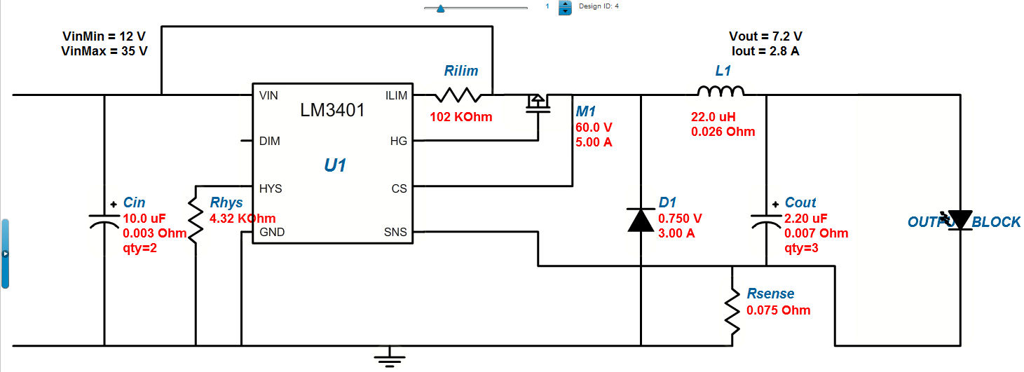

I was trying to catch whether there is just one led, three in series, two parallel strings?
There was a question like this started here before with a more enlightened discussion of what's involved. I'm stuck with vendor engineering, so here are some more links that might prove interesting.
If you don't mind signing up, the National WEBENCH online software has a comprehensive led selection. The list includes SSC's P7, and will make a complete bill of materials for the driver. The **broken link removed**seems like a viable candidate for an auto application.

I think I decided to build the circuit I used the webench software I'm not sure if I can order the parts from the site or I have to source the parts.. the only question I have is what do I mount it on? I have the eagle program but I've not used it for anything yet and not sure where to start at.

You will have to source the parts. Can't help you with Eagle, but willing to help locate the parts. Yesterday I was checking and it seemed that Mouser had quite a few parts spec'd by Webench, might take a couple of sources to get all them.

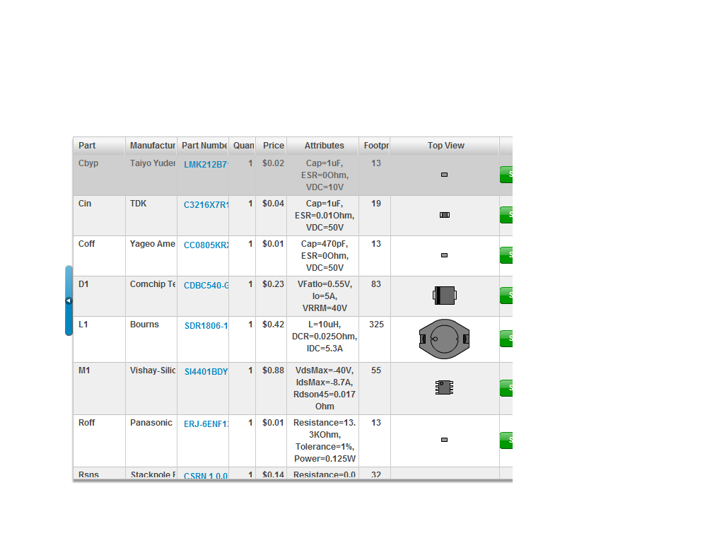

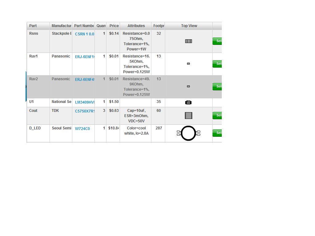

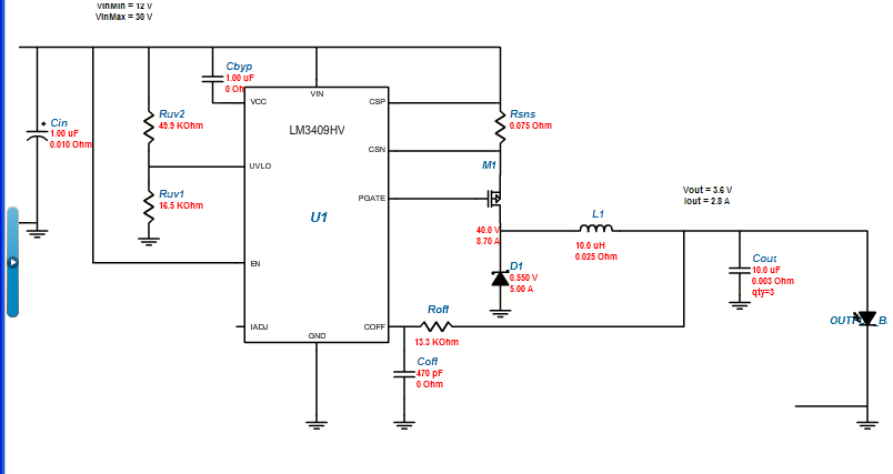

Big help if you could download a screenshot of the schematic, and the bill of materials (Ctrl+PrtSc=>paste in Paint=>crop to fit=>save as .png file=>attach file). I will test below. The LM3409HV is an automotive grade part, with a 10 pin MSOP + exposed pad pattern. Everything is spec'd as smt, so a pcb is probably the way to go.

hmmmm this is the one i saved here

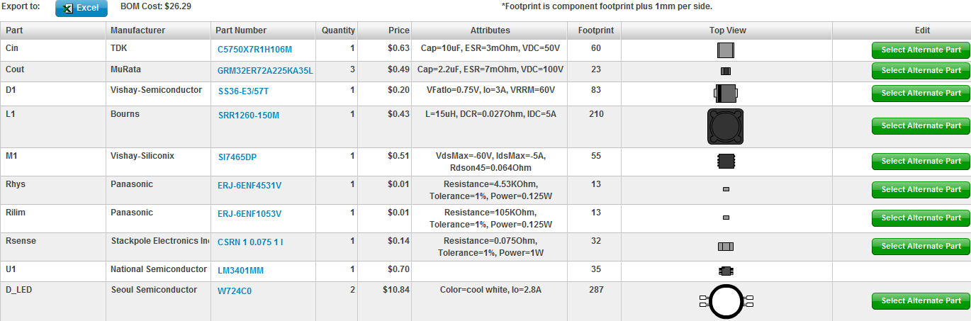

I found everything on mouser but 3 things.. the 2 Panasonic resistors and the LM3401MM
here is the one I have here
