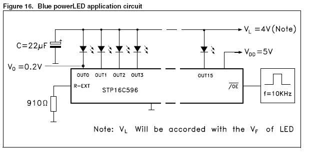

I am using an STP16C596 as a constant current LED driver. I am not interested in using any logic, I just want the device to turn on all channels all the time. I used a similar device in the past, a Toshiba TB62701AN. I simply set SDI (serial data input) and OE (output enable) high on the device and it turned on all the channels without a CLK signal. On the STP16C596, it seems like I need to set SDI high, send 16 pulses on CLK, set LE (latch) high, and then set OE high. This prevents me from using the STP16C596 as a stand alone LED driver. Is there a state I can set on all these inputs to simply turn all channels on all the time? Your help is much appreciated.

Hi, from what i see from the truth table i reckon u should set OE to low instead of high... give it a try and post the results.
Good luck!
Sorry, I had a typo. OE was set low, not high. Thanks for the correction hentai.
However, I still have the problem.
i see... well try seting LE low too and see what happens...
also have u looked at this application from datasheet?
I tried it but I get no output.
I only get an output if I set SDI high, pulse the clock, set LE high, and then set OE low.
hmm tricky chip... from the datasheet internal layout i would have guessed it only needed OE acitve (low) and the leds would be on...
Have u tried it like this, leaving sdi,le and clk unconnected thus high, and OE set low?... i mean with these settings already made at power on not making them in a sequence...
I ended up using two 555 timers to make it work: one for a simple square wave into the CLK, the other to delay the latch (OE) by approximately one second after powering the board up. So the drawbacks are more components and a one second delay to turn the LEDs on on initial powerup. Thanks for the advice Hentai.
