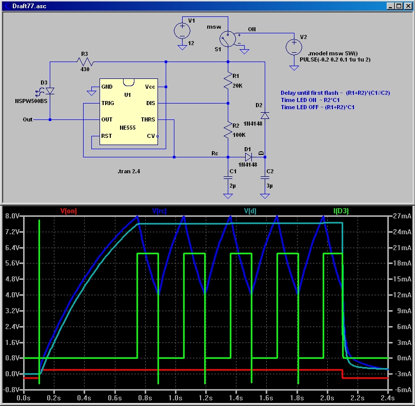

Maybe you can do something with this:
MikeMi,
This is utmostly interesting.
Could you pls tell me where in the world did you find that and what it is for ?
Thank you
Phil

I designed it after reading this series of posts...
Just for you ...
