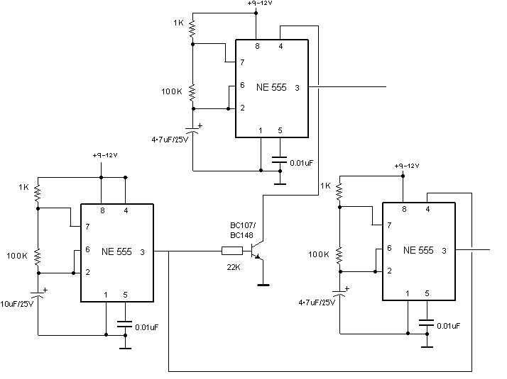

I have just obtained some high intensity LED's. I want to use two pairs of them and flash them alternately. I want one pair to flash 3 times in about 1/2 second, and then the other pair flash 3 times in about 1/2 second, and alternate back and forth like that for about 5 cycles. The actual timing is not critical as this is for visual effects. I have a couple ideas myself on how to do this, however I need a circuit that uses as few components as possible. I'm afraid my ideas might have too many components. I want to drive the LED's with about 500mA, as they are high intensity and can take that current. My goal is to use as few components, and consequently as little space as possible. Any suggestions would be appreciated. Thank you.

I think this may be what you're after. You may need to alter the values of the resistors / capacitors to get the timing cycle you want.
You can use just about any small NPN in place of the BC107
The output of the 2nd and 3rd 555's (pin3) will supply up to 200mA, use them to drive a suitable NPN transistor if you want higher current.
I built one of these a while ago on a 7cm X 3cm stripboard, so size shouldn't be a problem.
Edit: If I've made any mistakes in the schematic, I'm sure someone will notice and correct me.

Pin 4 of the top 555 needs a pull-up resistor. 10k is fine.

Thanks. Knew I'd miss something.:)
Sorry, looks like there was a miscommunication. I have 10 square centimeters to work with. That's why I'm thinking even with the smallest surface mount stuff using 555's won't cut it. Using 555's was my first idea, but space is at a premium for this project. I might be able to go up to 16 square cm but that's pushing it. That's why I'm thinking I might have to finally learn microcontrollers to make this work in the space I have. I should see if I can actually fit three 555's and the other componenents onto such a small board. As it is my first time using surface mount stuff, going this small will be pushing my skills.

You should be able to create the unit within your 33mm x 33mm area if you use SMD parts. If you are driving the LED's with 500ma each then you will need a 1.2 Amp (min) switching regulator and some FET's to drive them. How high can the solution be ?
500mA?
You need some pretty chunky LEDs, 350mA units might do if you only want short bright flashes.
