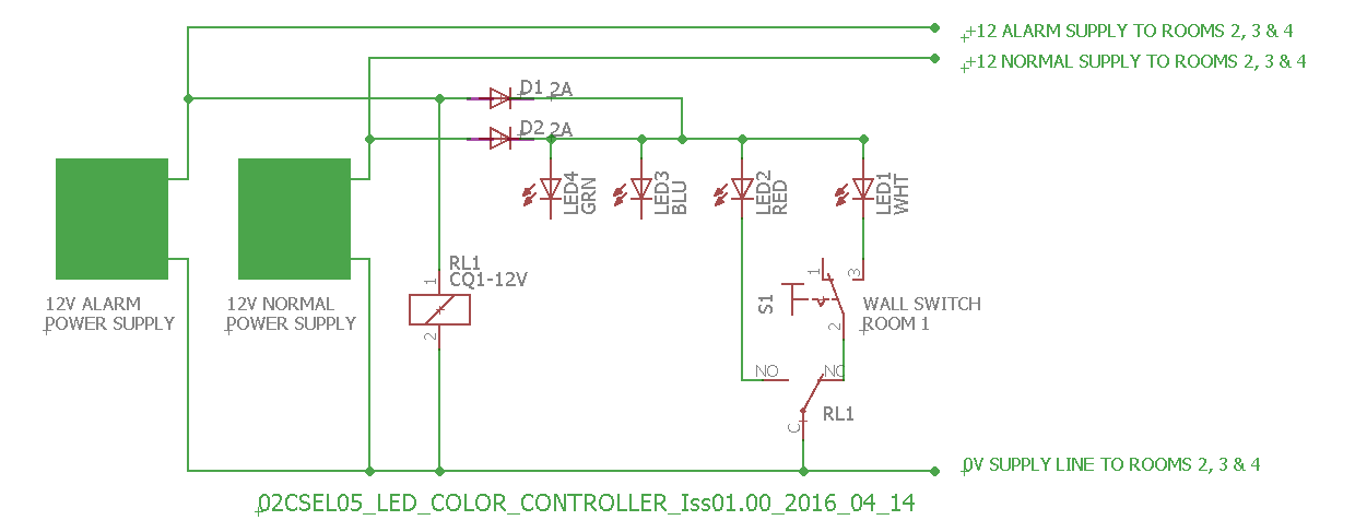

Hy Cbello,
I didn't bother with the questions as there is sufficient information in your original post. Here is a schematic which I think meets your requirements.
There is one point of concern. It is normal to drive LEDs with a constant current but you are driving them with a 12V supply, or do the LEDs have built-in constant current generators?

(1) Relay 1 is a common car (automobile) 12 Volt single pole change over (SPCO) type which are freely available and cheap.
(2) Diodes 1 & 2 are rectifier diodes of 2A minimum current capacity and 24V minimum peak inverse volts. Many types will be suitable but Schottky would be best because of the low forward voltage drop. The diodes are also low cost.
ERRATA
(1) The top traces to each 12V power supply are the positive outputs.

Hy Cbello,
I obviously have not understood what your layout is like.
It was my understanding that you were going to power the LEDs, not with the mains supply, but with a separate 12V supply.
It was also my understanding that the alarm signal was also a 12V supply line with sufficient current capacity to drive the red LED.
When you drive a LED you don't put a voltage across it, insted you put a constant current through it. This is because the forward voltage of a LED (when it is on) is not accurately defined so with a voltage applied the LED may take excess current (and fail) or too little current (and not be sufficiently bright).
I do not understand what you say about the dimming function at the moment.
We need to sort out what you circuit is. Could you sketch a schematic.
In the meantime treat my schematics as tools for discussion until things can be fully defined.
Here is another version of the schematic where the alarm line does not power the red LED which instead is powered by the same 12V supply that powers the white LED. The alarm signal only has to supply 80mA to operate the relay.
Once again this circuit is only a vehicle for discussion.

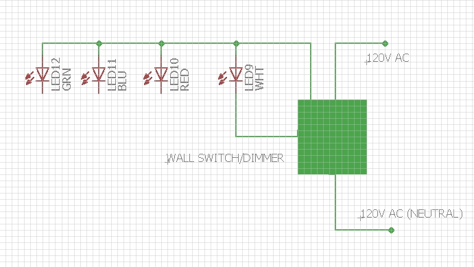

Cbello,
I may have figured the way the light is wired. I will post a schematic so that you can see if it is correct.
spec
I will try to post a diagram later when i am at my desk.
To AK, yes you have points 1.2.3 correct. But no there is not any analog control of the unit.
So let me back up... the current system is a simple 12v wall mounted light that comes on solid because it is being closed by a computer controlled relay when an alert is sent. There is currently a 120 to 12 volt power supply in the basement that is always on, but the circuit doesn't complete until that closure takes place.
I just realized trying to word this is difficult, let me go paint a picture haha, I'll get back to you

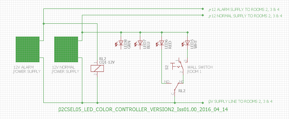

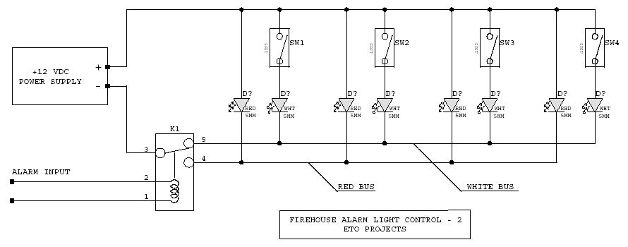

Here is my interpretation of the requirements. Many other options are possible, such as moving the relay to switching the returns, replacing the relay with a pair of power MOSFETs or power BJTs, etc.

Let's see if I understand the requirements correctly:
1. Normally, four rooms have completely independent control of their white lights with four independent wall switches.
2. In the alarm state, any white lights that are on go off.
3. In the alarm state, all four red lights come on regardless of the wall switch position.
If all of that is correct, then one question - do the 12 V power supplies have a low-voltage input signal for output enable, output disable, global shutdown, something like that? Many industrial supplies do, and if they are there then all of the control can be done at the low energy level. Starting with spec's two supply scheme:
4. All red lights go directly to one supply #1 without any wall switches. This supply is enabled by the house alarm signal. We'll have to work out the interface for that, but I've done a lot of these and it's pretty simple.
5. All white lights go to supply #2 through their individual wall switches. This supply is enabled/disabled by the 12 V output of the supply #1. No relays, no diodes in any power path. Both supply outputs and all lights common-grounded.
If the supplies don't have output enable signals, then one SPDT relay will be needed with an alarm control circuit (maybe just a relay coil driver), but now you're down to a single power supply.
6. The signal coming from the station that changes the lighting, "a 12v circuit that closes" - sounds more like a 12 V source that is turned on in the alarm state. Can it handle another 0.1 A of relay coil current?
ak
I think the OP also stated (in post #1) that the LEDs are switched from the ground side with the positive side common to the power supply.
Return side switching.
ak
  • FireHouseLights-2-c.pdf
Thanks, I apologize, I haven't yet had a chance to get to my desk yet.
This is close.. The fixtures are 5 five wire. There's 4 grounds (one for each color LED) and 1 positive that has to be energized to make any of these work. The problem lies in me wanting to dim the white light.. because that requires both the + and - running through a pulse width mod dimmer.
After some consideration, I think we might just go with something simpler. We might just mount 2 fixtures in each room. One red and one white on two totally separate systems. It's not as fun, but will require much less low voltage wiring.
I can't express how grateful I am for all of your ideas and help with this. Ultimately this LED fixture's white light mode isn't quite bright enough and would mean doubling my fixtures.
Yeah, given the incredible amount of R&D in the last 10 years, nothing is going to get you the white light efficiency of a true white LED.
And separate circuits, as in either schematic, means the white LEDs can have dimmers, remote controls, whatever, that don't affect the red LEDs.
