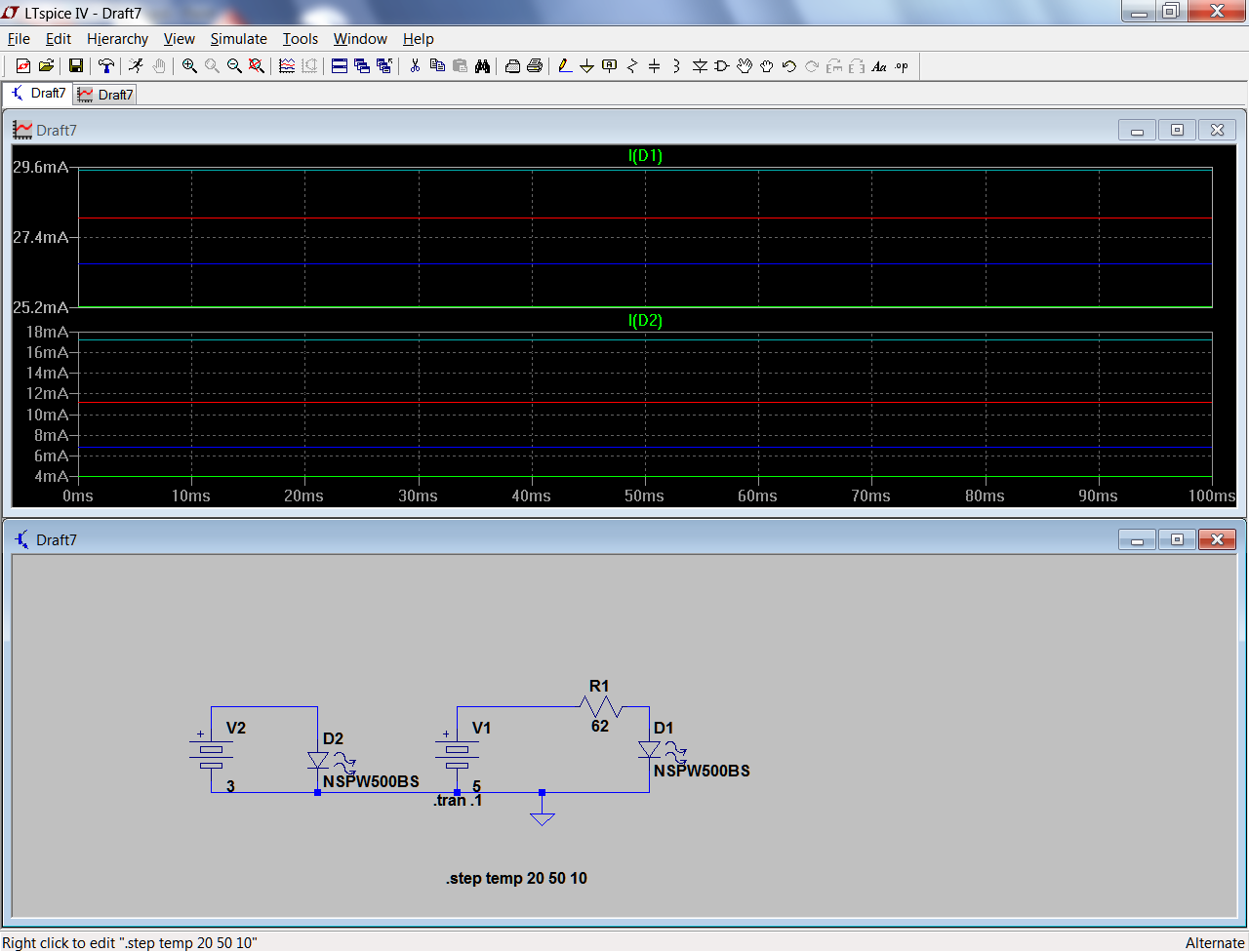

Vf also has a curve. At low current Vf is lower. So your LEDs attached directly to the 12 volts are running at a much lower current than you might think they are. Perhaps 5 or 10 ma instead of 30. If they are bright enough for you this will work.
Here is a simulation of your condition at various temperatures. As you can see the diode with the limiting resistor has a variation but is much brighter than your LED. But yours has a wider variation with temperature.

Well ronv, thank you for that simulation.
What I gather from that is, that the use of the resistor 'smoothes' the conditions when the temperature varies.
For me the question remains how to find the optimal resistor.
And, like in the case where I could use 4 LEDs in series to be powered from a 12v supply, if it would be advantageous to go, lets say, to a 14v power supply just to employ a limiting resistor?
