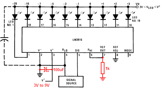

Hi Sam,
You forgot to attach the schematic of the circuit you built with the LM3916.
The first circuit in the datasheet has two resistors that make its max sensitivity low. It is 10V full scale. If you wire it like this then the full scale sensitivity is 1.25V.
The LEDs will be blurred and dim with music. It needs to have the peak detector circuit shown in the datasheet for the LM3915 to stretch short duration peaks so you can clearly see them.

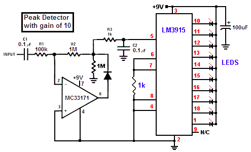

Here is the schematic i used. I dont have pin 9 connected.
Add this peak detector with gain circuit. The MC33171 is an improved version of the old single supply dual opamp the LM358. An ordinary 741 opamp won't work.
