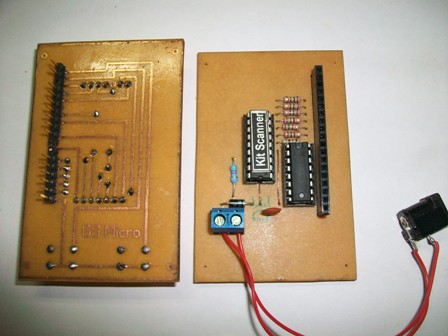

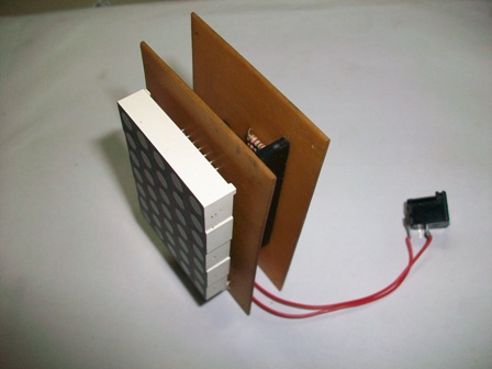

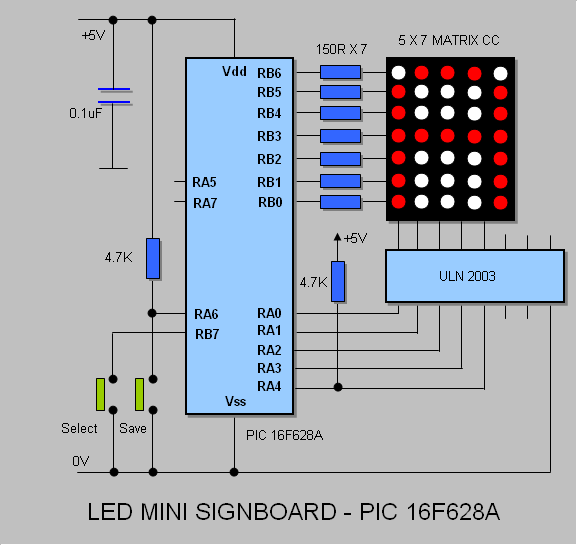

Here is a present for Mike K8LH because of his help giving to signboard lovers.
This project Named LED mini signboard.
Features
*User define message (String length = 30 letters including spaces)
*50 different characters = A-Z, 0-9 & special characters
*Battery power operation 3.6V-4.8V
This is the smallest signboard I have ever made. The nice thing with this design is you can write your own message using its two buttons.
Saving is pretty simple
Press & hold the “Select” button at anytime. It will show you letter “A”. Now release the button. At each press the “Select” button it will shift to next character.
Press “Save” button to mark the selected letter. Likewise make a sentence by the two buttons & after completing press & hold the “Save” button for 4 seconds so it will save the whole sentence in the memory. Release the button now it will scroll the message nicely that you saved.

For additional details visit my blog https://gsmicro.blogspot.com/2008/12/mini-signboard.html

Great project. I want to build it but can I substitute the uln 2003-darlington array with something else as I cant obtain one of these yet.

Hi justDIY there are five display column registers.But all the code is done with another five of working registers.At the end of the each display frame I'm loading working registers to the column registers.
Actually this project a bit hard & gets lengthier. The secret is withing the offset values to the table patterns :D

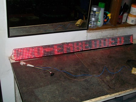

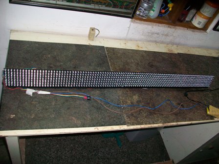

Here is another design of mine.The hardware is similar to your method with some minor changes in column driving side.
I cannot resist I want to show.
YouTube - Sign Large
