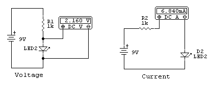

I bought this big bag of LEDs, all different kinds... so i figured with my multimeter i could figure out current draw, voltage drop, the kinds of things one usually likes to know about LEDs, however, i am not seeing any function that will do that....
do i need to actually hook a battery up to them and see what is going on? i am only hesitant to do that cause i dont want to burn them all up seeing what they are!
any suggestions would be great!

The fourth range is Continuity Tester/ Diode Checker. Rest all are correct.
For testing the operating voltage and current through an LED use the following circuit.

Kinjal's second schematic for measuring the LED current is only telling you how much current YOU are letting the LED draw, it being limited by that 1K resistor to a value of (9-Vled)/1K
The current you want is the maximum current that the LED can handle without being destroyed, and that is not a measurable value. Takes a data sheet for that one. However, most LEDs will handle a maximum of at least 20ma.
You don't need an ammeter for measuring the current. Just use the same circuit that Kinjal provided on the left, but instead, connect the DC voltmeter across the 1K resistor. The reading you get on the meter is directly equivalent to the number of milliamps flowing in the circuit. Assuming that the resistor is reasonably accurate, this is a more accurate method of measuring current anyway. Ammeters usually insert enough resistance into a circuit that they change the actual value of current, lowering it somewhat.
Be careful of REVERSE voltage across an LED. Where most diodes can handle anything frm 40 to 2000 volts reverse, depending upon the diode type, most LEDs have a maximum reverse voltage rating of anywhere from 3 to 5 volts. More than that at higher current levels can damage the LED.

Yes, Dean the second schematic will show only the current R1 is allowing. That was an example of showing how to measure current through an LED. This is definately not going to show its max. current capacity because if you allow an LED to go upto this limit it will never return back. For experimenting purpose there is no harm in connecting LED with a potentiometer and slowly decreasing the pot. resistance until LED burns out. That current will be its max. limit.
