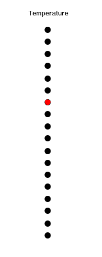

Are you trying to do something like this? Where as the temperature goes up a higher led would turn on? (and vice versa).
If so use one of the chips recommended bellow to get the temperature into an accurate current then use multiple LM3914's tied together to give a bar graph appearance.
EDIT: never mind you probably don't want this sort of thing because it won't give you numbers.
