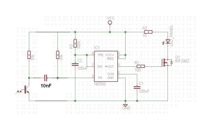

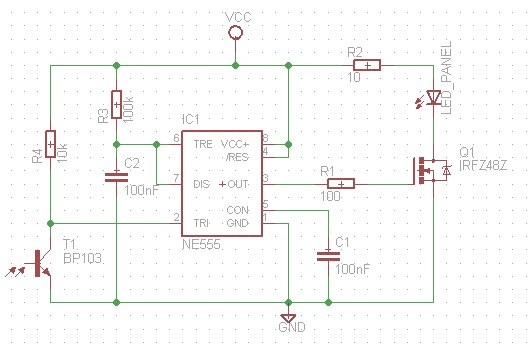

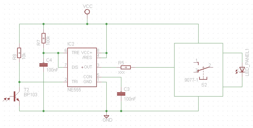

I used the attached schematic, which is fairly simple and so far the test results are ok. The logic behind it is to actually overload the panels with an impulse of max. 0,1s with 10% duty cycle. The panels are rated at 12V/300mA and yes, I know I might burn them, or one of them, by increasing the current, but I'd really like to build them. The characteristics I found on the Internet so far are saying about a ratio between 1/3 - max 1/10, between the rated current and the peak current. While I'm not sure I will peak the panels with 3A individually from the very beginning, I'd like to experiment with 1-2A peak.
0,1s is more than enough for studio shooting, most of the cameras go out of sync after 5ms so I can easily lower the duration of the impulse. The FT is not very sensitive, which is good, right now it can be triggered either by a very close LED flash-light or by the built-in camera flash. In the schematic, only one panel is shown, I will actually use 5 either in parallel or put more MOSFETs. I still have to tweak the MOSFET saturation and the panel currents, this is an ongoing work.
My questions so far are:
1. How can I reset the 555 timer in such a way that after 0,1s (T) is stays off? In other words, if the input impulse is longer than T, let's say 1 sec, then how can I make sure that the output is reset after 0,1s? By this, I would like to prevent burning the panels in case of an accident when there is a continuous and strong light in the FT. Also in other words, I would like the 555 to be triggered on the raising front of the IN-impulse and not to actually care about the duration of the IN-impulse.

In response to your question 1, try this:
I have used this solution before to overcome similar problems with other applications using a 555.
Thanks JimB, I tried the option above but it isn't working; this is because impulse is too weak to get past the capacitor and still fire the TRI. An option suggested on another forum was to use an Op Amp but the basics are still the same. I will put in on a breadboard tomorrow and see the behavior.
I still need to figure out #2.
OK, I was making the assumption that the phototransistor would turn on hard when it sees light.
If the opto was an ordinary switch I am sure the thing would work (he said hopefully from memory!).

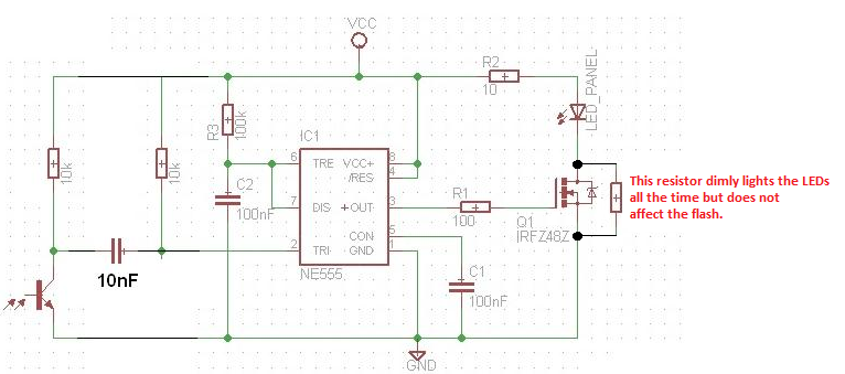

To light the LEDs dimly then simply connect a resistor parallel to the Mosfet. The "flash" will still operate like before.
Measure the voltage at the collector of the photo transistor in bright light and normal light. You may need to adjust the resistor pull up.

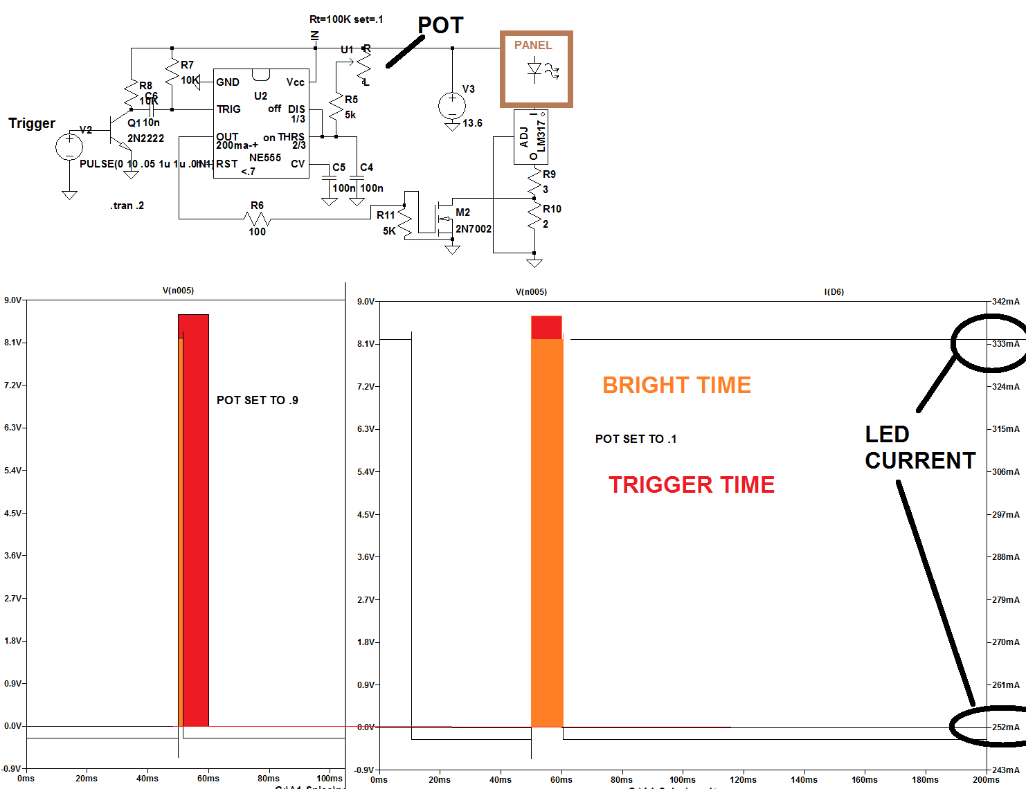

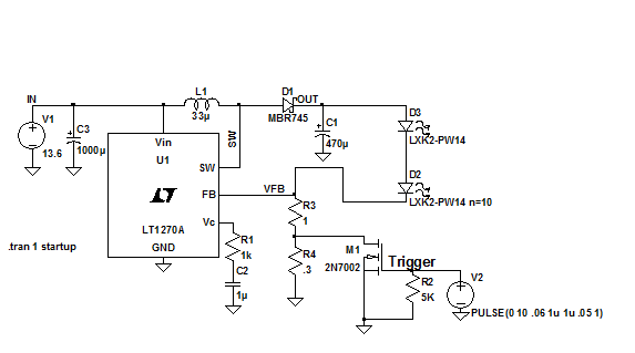

I have some leds that I use for driving lights on my off road vehicle and I use a boost circuit and for the feed back, I have an inline resitor that is matched to the current needed, something like this would probably work for you also. Hope you can run this sim, if not, post and I'll post the results. What happens is the lights come on at a percentage of your choice the go full bright of over or under by you settings. What LEDs are you using, what is their voltage and current rating?
PS, this circuit was designed around 24 3 watt bright white LEDs in series and 1 amp of current.

How many panels do you have? can you run spice?

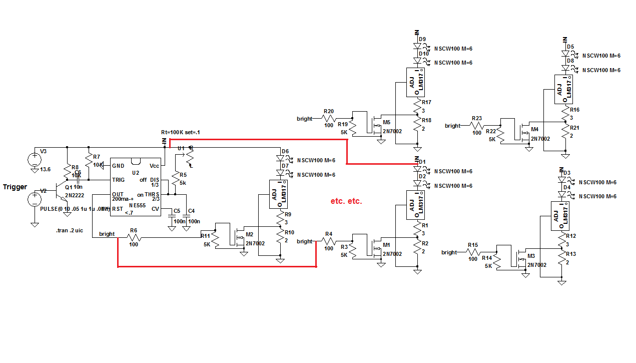

Here's a couple more ideas
  • pos1t.asc
  • post.asc

What do you have for a power supply for these? May I suggest a cheap 4 amp battery charger and handfull of 25volt caps, say 5 1000 uf caps.
What is your trigger for this? It only needs a spike to trigger, but will only run for what ever time you set it for if its a longer duration than set time, I may have components that need changing for longer time period.

Why do you need a sketch of a simple parallel resistor? Here it is.
Add a switch in series with the resistor to turn off the dimmed LEDs if you want.
Use Ohm's Law to calculate the value and power rating of the resistor.

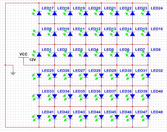

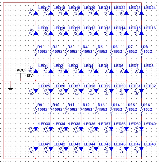

Thank you all for the advises, the resistor in parallel works just fine. However ~!@#$%^&*() I've started with the wrong assumption that the panels work just like a big dumb LED rated @ 12V/300mA - I couldn't be further from the truth. It turns out that the panels have a built-in resistor like in attachment, so it seem that no matter what I do, I will always have a limited current on the panel. Shorting the resistor will get them brighter but I am thinking of "cutting" the contacts on the PCB and connect them like in the 2nd attachment.
What strikes me so far is that even though the MOSFET is saturated, Vgs > 10V, I still cannot draw more current from the source. With all 5 panels, the schematic barely draws 0,8A when it should have been a little over 1,5A (5panels * 300mA/panel * xxmA rest of the components). I tried with other MOSFETs (also IRFZ44N) and I even replaced it with a BJT with the same result. If I connect a panel straight to the power source it does draw ~250-300mA.
