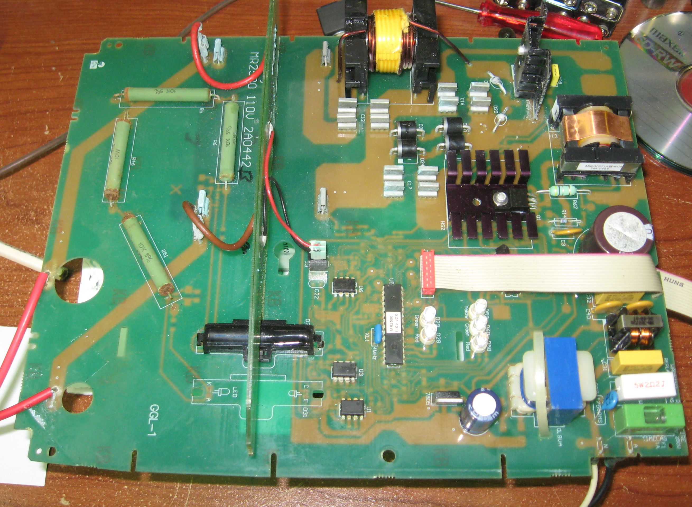

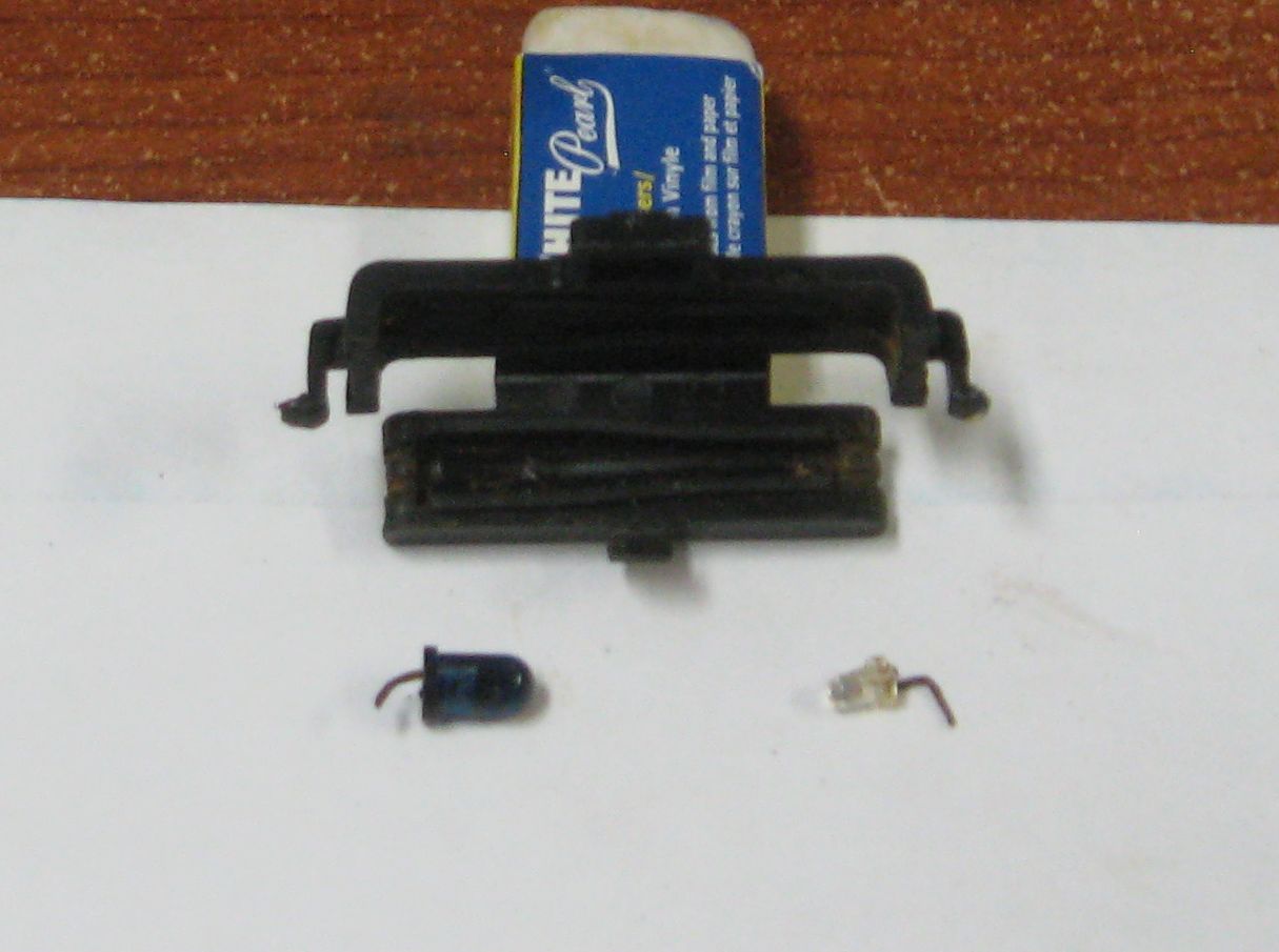

Hi, I know it's a long shot but has anyone seen a put together optoisolator unit like this? The left unit is an led and the right unit is a phototransistor. This is from a Gallagher MR2500 farm fencer. It's used to couple a sample of the high voltage pulses to a monitor circuit that lets the user know the output status of the fencer at a glance by flashing a green led if the output is ok or a red led if the output is low due to a leaky or shorted fence. The lead wires have rotted off due to moisture getting into the fencer and I am trying to repair the unit. The second photo is the fencer's circuit board. There are 2 of these optoisolator units as can be viewed.

The plastic package looks custom to me, but it can be replaced with a piece of unshrunken shrink tubing, a dark soda straw, a small cardboard tube, a roll of paper, etc. Its only purpose is to keep the two parts in rough alignment and prevent light from one causing a false signal from the other.

Hi, As I mentioned in my post the lead wires have rotted off both the led and phototransistor where they pass through the circuit board. This can be viewed in my first picture.
I was unable to open up the other unit without the lead wires breaking away from the board.

The flat is the polarity marking. The emitter likely goes on the HV side. Just noticed that the board is already marked.

Some expert use of a dremel and solder iron might get you some copper wire soldered to the stubby bits, you might be able to remove 1/16 or so of the plastic as the die/bond wire is fairly well buried.
Ok, I should mention that in the first picture the device on the left which is dark colored is the led and is bigger than the phototransistor which is clear and on the right.
