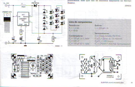

You can use a switch mode regulator to regulate the current, with little dissipation and choose between 2 different currents. One lower other higher. You should choose a stepup regulator and connect all leds in series, this way they will have equal brightness.
The problem is that I have 6 boards all wired in parallel - so basically I have 6 boards (3 for each side of the car) with 8 rows of 20 LEDS on strip board. I can rewire them so I have each row of 20 LED's fed individually with no major problems, but removing them all and wiring them in serial is a little more than I wish to do.
Its not advisable to connect leds directly in parallel, because of slight differences in them. One will glow different from another. To connect them in series with an individual resistor even of a very small value to "equalize" them. You can test this by connecting 2 different color leds in parallel and tri to light them with one resistor. About the 8 boards, if you could connect the 20 leds with a 10ohm smd resistor each, you have 8 boards with 20 led/resistors in parallel, now you connect the 8 boards in seris and use the step-up regulator network.

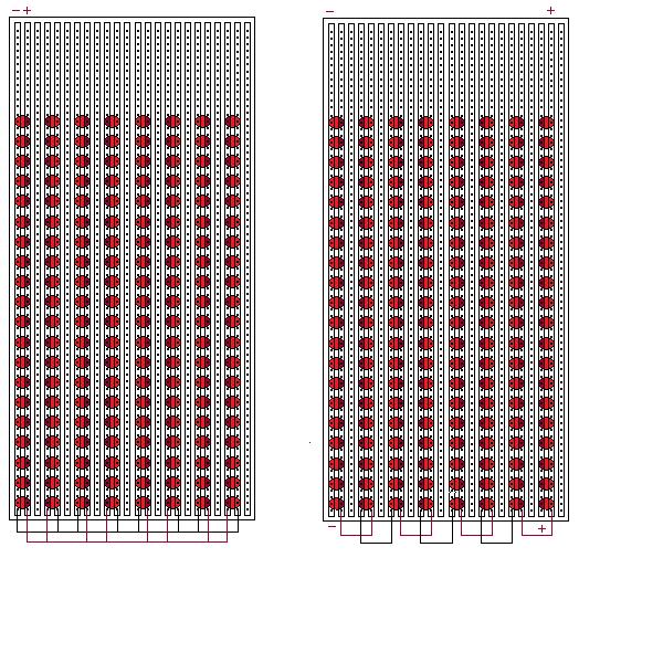

OK, I will rewire the boards to run a group of 20 LED's in series with each other - i.e. lots of groups of 20 LED's daisy chained together.
So this will mean that I have 48 groups of 20 LED's - so what resistor should be recommended for this application/format? I think it may be best to run each board (8 strips of 20) individually with a resistor per board. Does this make sensible logic?

With 48 groups in series you will need about 96 V :eek: which is more that the battery's 12 V :D
Each board of 8 strips, in series, will need about 16 V - still more than the 12 V hou have.
I recomend using series of 4 strips, making 2 series for each board (that is 6 series for each side of the car).
Each series should have its own 11.6 :ohm: 10 W resistor.
Be shure to allow for plenty of air flow arround the leds and resistors. each "lamp" will be dissipating up to 15 V x 600 mA x 6 = 54 W and can get very hot if enclosed.
As about half of this power will be in the leds ant the other half in the resistors. I would put the resistors outside the lamps, and if possible outside of the car´s trunk - Perhaps under the car, using plenty of heat shrink tubing to isolate every connection.

I will draw a little plan of what I have and see what wiring ideas you all have.
Mick . . .
I have drawn a very simple layout of what one of the six panels looks like, and what I guess I can do very simply to the links connections to alter the panel to a "20 group" in serial type.
The one on the left is what I have - i.e. 8x20 LED's all in parallel.
On the right is an example of what I could do to change it to a collection of 8 groups of 20 in serial.
I will obviously have to limit this pattern to just 5/6 runs of 20 per 12-15v feed though.
Mick . . .
