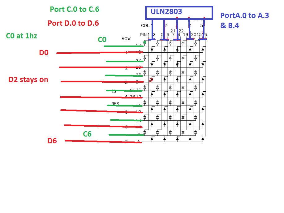

Here is what my present circuit looks like
I just might have a glitch in my wiring but ?
Going to start from scratch and use a smaller resistors something between 50-120 ohms.
Presently just trying to turn on individual leds (note the matrix is bi-colored) but several problems occur.
Turn on one GREEN led in column (1-7) by going HIGH and making the input to the ULN2803 HIGH thus one LED should turn on.
Not the case. I have say column 3 Green flash at 1 hz But the Red led in same row but column 5(1-5) just stays on, no blink. Change the Green LED to say column 1 and same RED led still stays on while the Green blinks
PLUS row 5 won't come on at all. Either will any LED in colum 6 or 7.
Pretty sure its a connection malady.

Mr. DEB,
You show only part of the LED driver circuit, the ULN2803A column driver IC that has a typical output saturation voltage loss of about 0.8V if only one LED is lighted and it might be 0.9V if 5 LEDs are lighted. We don't know how much voltage loss there is in the row drivers because we don't know what they are. So it looks like there is no way your LEDs with a maximum forward voltage of 5.0V will work when the supply is only 4.5V which drops to 3.0V.
It is the logic that drives the LED drivers that causes an LED to light or not.
The LEDs light up BUT I have a major glitch as only one LED is supposed to be on but I have two LEDs on.
One Green LED is blinking as its supposed to do BUT I have a second red LED that stays on but its not even programed to come on.
Going to start from scratch and maybe find out why?
The matrix is not very well marked but have verifyed which pins are which.
I suspect that when I designed the pcboard I inverted a component or ??
Etching a new board tomorrow and maybe get correct results.
