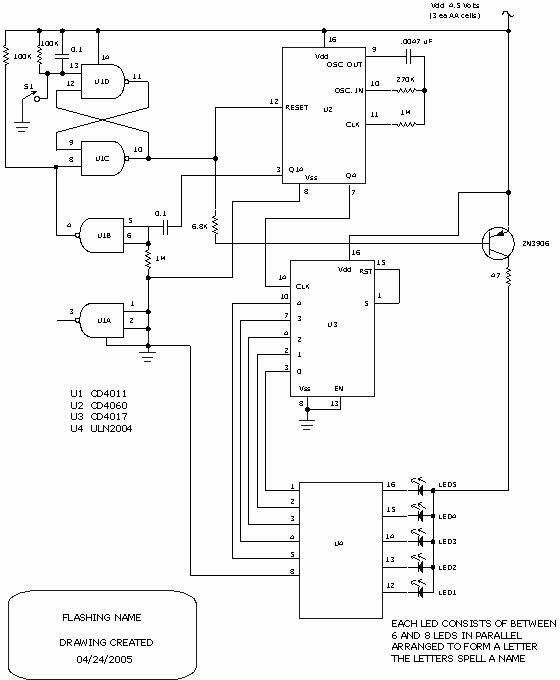

Here is a circuit I developed a couple of years ago for my girl friend. I drew the schematic on the computer today.
I flashes the individual letters in sequence fairly slow. When S1 is depressed the letters start to flash. After about 5 sequences it turns itself off. If you wanted the letters to flash all the time you could eleminate U1 and ground pin 12 of U2 and delete the 2N3906 transistor with a jumper between the emitter and collector terminals.
The one I built also played a melody for the same time. I didnot draw the melody circuit, as the melody generators by Holtek are no longer available.
