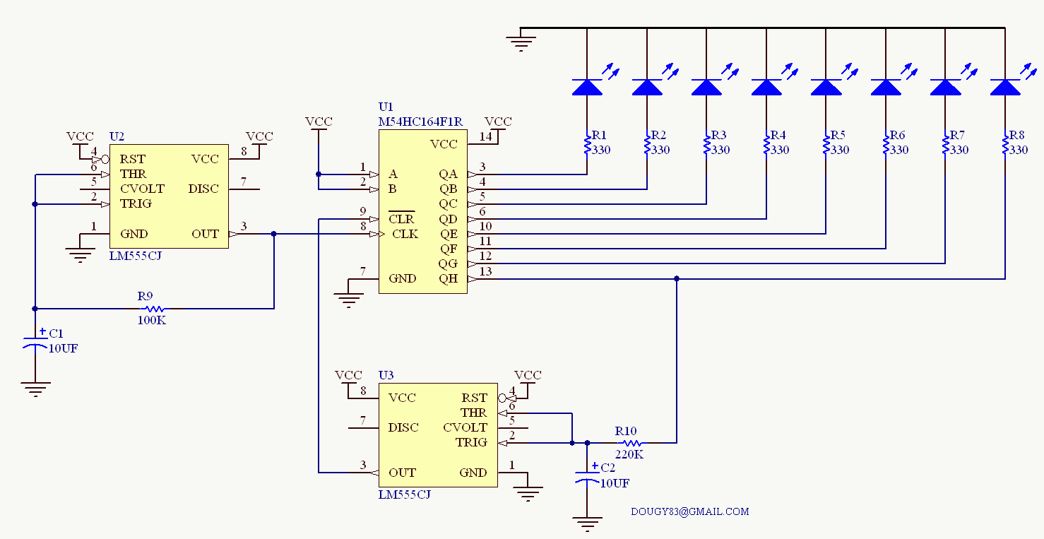

Hello everyone,
I'm pretty new to electronics and the most complicated circuit I've ever built is a 555 blinking LED; I can build things successfully, but I'm not very knowledgeable and things usually only come out nicely if I am instructed on what goes where =P. My school team is trying to make a sign for an event and we wanted to make a light-up, animated shooting star. I was wondering how this could be done, if at all, with LEDs. I did find a circuit that may work but I want something that would light up one LED and then the next but leave all of them on until the sequence was complete. So, one lights up and then the next and the next and then like a big circle of LEDs at the end and stay lit for a few seconds and then start again. Does anyone have advice?
Thank you, Nick.

Or try this one. U2 clocks the shift register, which gives the chasing effect (without the leds extinguishing). When all leds have been lit, and then a few more seconds (C2 charging), U3 clears the shift register and then after a few more seconds (C2 discharging), the sequence starts again.

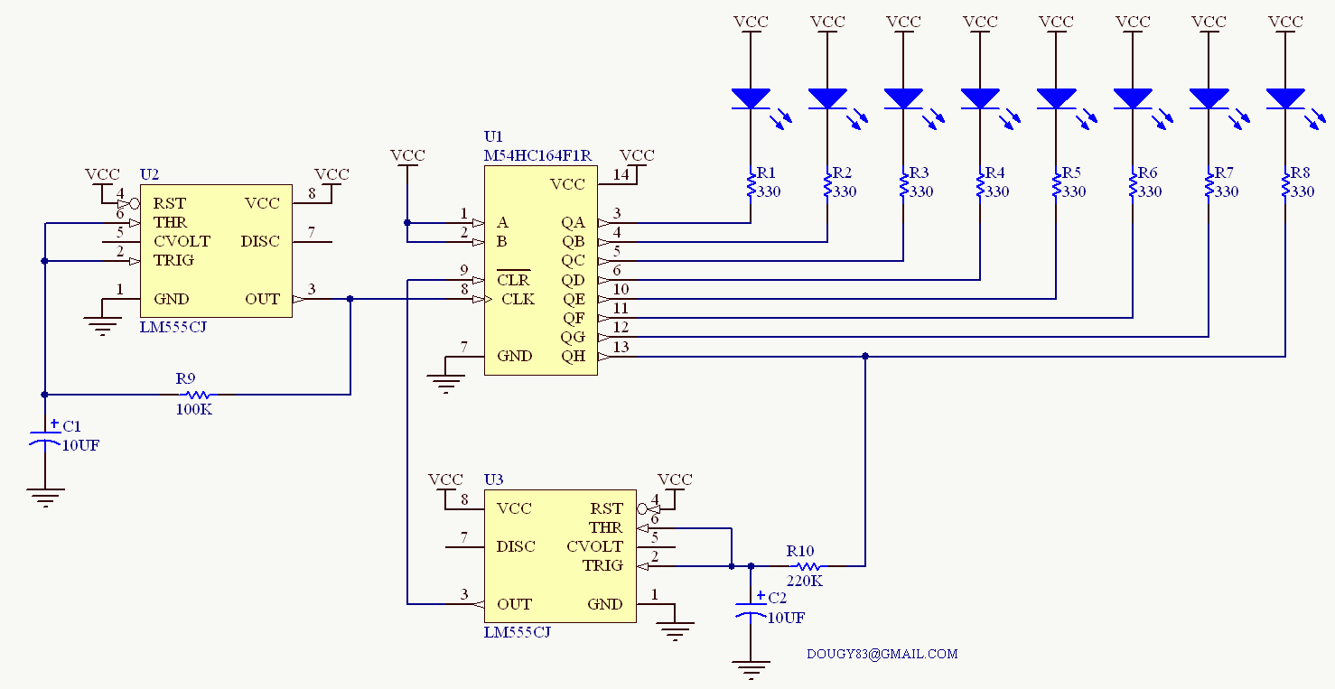

Sorry, LEDs were backwards on the last circuit I posted. Try This:

Hi dougy83,
I'm afraid your timer IC won't be triggered that way. It's floating if the counter output is low and goes high when the counter output is goes high.
Triggering must be a negative going pulse edge.
Boncuk

Hi dougy83,
Boncuk
I didn't understand what you said. What is floating? What counter are you referring to? Who is triggering?
U3 can't work as well as U1. U3 receives a positive level shift which will stay there forever.
U1 can't work because charge and discharge resistors are missing.
U2 provides a clock to the shift register, which clocks in Logic '1' along the outputs. When the 8th output becomes high for a time determined by R10 & C2, U3 out goes low. This clears the shift register & all of its outputs go low. C2 is now being discharged through R10 by the 8th output of U1 (which is low due to clearing); when discharge sufficient, U3 output goes high and allows the shift register to clock in the logic '1' once again.
I'm not sure what you're having trouble with, for U1, the clock is edge triggered, while the clear pin is asynchronous.
Just refer to the NE555 datasheet. It can only be triggered by a negative going pulse edge at pin 2 (TR).
I mixed up U1 and U2, assuming IC count from left to right. U2 will not provide clock pulses with that wiring.
The NE555 output goes low when the voltage on pin 6 exceeds 2/3 VCC; the output goes high when pin 2 is below 1/3 VCC.
They are clearly labelled.
And why is that? Perhaps you should wire it up and see for yourself. In the mean time, feel free to read & understand the 555 datasheet & 555 operation and maybe even have a play with a 555.
