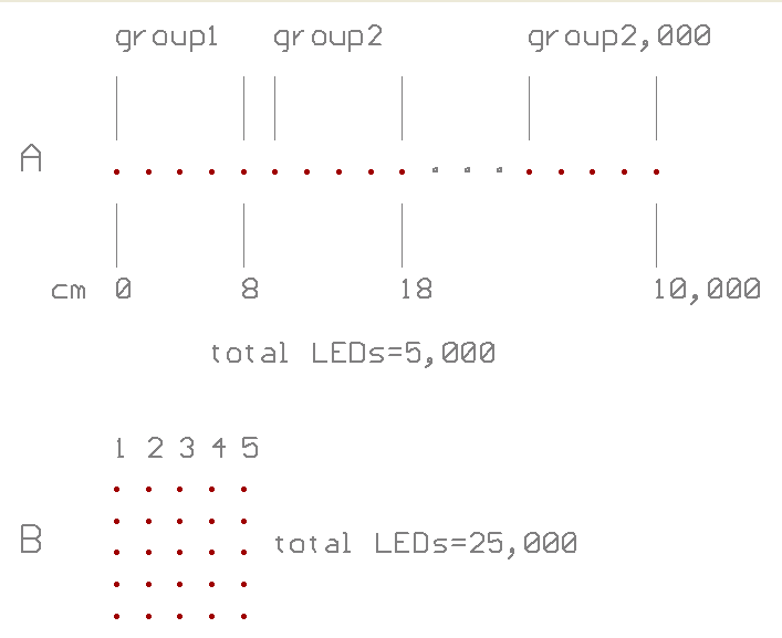

Hi daffy,
how many groups of LEDs are you planning to use over a distance of 10m?
If a group of LEDs is used with the LEDs arranged in horizontal order a group of 5 LEDs will require a total of 2,500 LEDs, if arranged vertically the total number of LEDs will be 25,000.

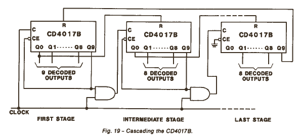

A single counter with 5 usable outputs won't suffice for your application. So you require multiple counters cascaded for the proper sequence.
Also, do all groups have to be lit in sequence, or do you want to light group 1 and 6, then 2 and 7 and so on?
Boncuk

Since only three or five LEDs will be lit at a time the power consumption will be relatively low, but the counter ICs and wires will be quite a lot - even using charlieplexing or matrix coding.
I've never tried to cascade 625 decade counters (with eight usable outputs) over a lenght of 10,000cm. I guess the clock signal needs to be buffered every 100cm.
If one group is arranged horizontally and contains 5 LEDs it still means 125 counter ICs.

if i am not mistaken he mentioned 10m = 10x100cm = 1000 cm.
spacing is = 2cm
no of LED used = 1000/2 = 500
Edit: if 5 LEDs in the group then total of 100 groups only.
If there are 5 per "group", that's 5X500= 2500, not 25,000! Whatever, seems like everyone gets something different from the post :)
spacing is = 2cm
You are right!
Sorry, math error on my side. :(
Stlll a lot of LEDs.

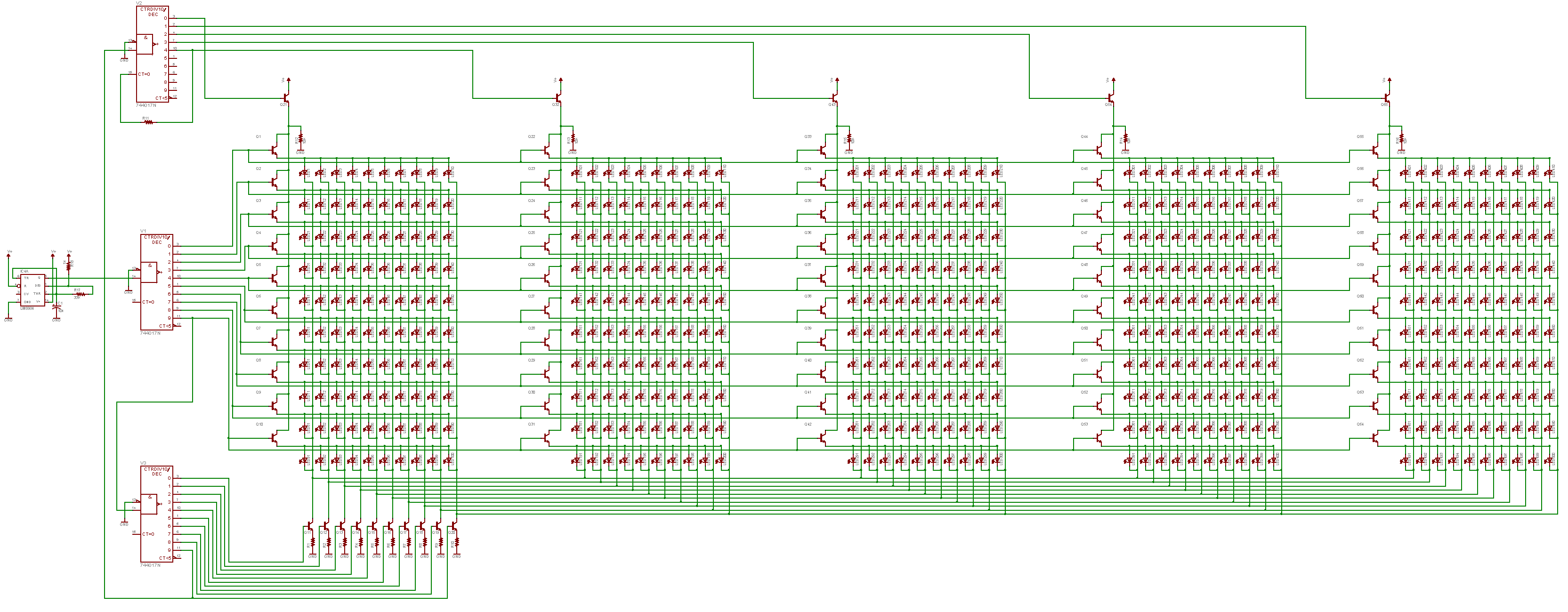

I thought of this last night. Is there any reason this idea wouldn't work? It uses 1 555, 3 4017s, 65 NPNs, and 10 current limiting resistors to sequence 500 LEDs each staying on for ~ .5 seconds. I think given a high enough supply voltage, the idea could be expanded indefinitely. For 2 4017s 100 LEDs, 3 4017s 1000, 4 4017s 10000, etc. What does everyone think?
Eventually, you would reach a limit on the fanout for the 4017, and would need a different scheme.
What limit would you reach?
Edit: Are you talking about leakage current through the 10KΩ resistors and the bottom transistors eventually adding up to the source capabiltiy of the 4017's output pins?
Every transistor that drives the LED's require a small bias current. No device will drive an indefinite number of transistors. What is the purpose of this system anyway?

If you want 1 driver per group of LEDs. It's going to work out to be very expensive and not simple to wire up. I must say I prefer vne147's matrixed version which uses minimal parts.
