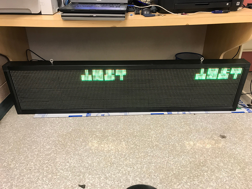

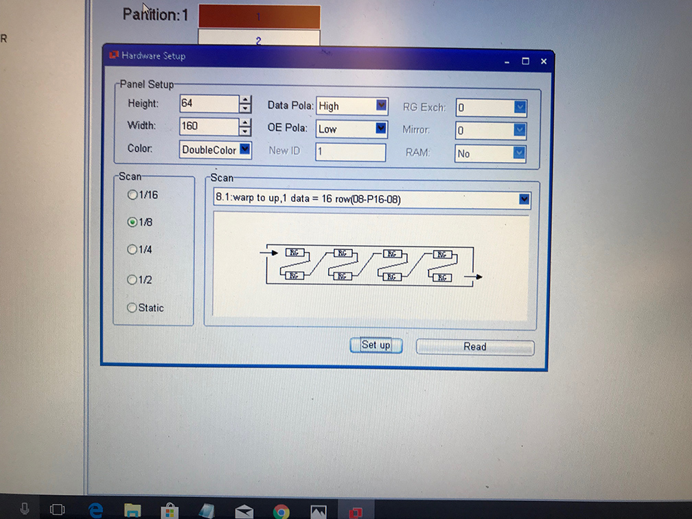

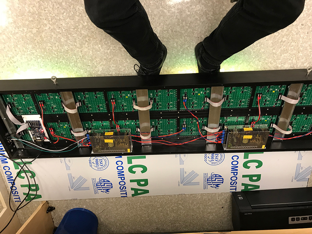

I recently inherited a 5 panel wide x 2 panel tall dual color led sign (160cmx32cm). The panels are P10RG-4S. With the help of reddit, I have managed to communicate with the Lyson Easy 50 controller. In haste (excitement) I accidentally wrote over the program that was previously on the controller, now when I try to load a new program, it transmits successfully, however the text is garbled, I believe the issue lies in setting the correct scan mode. The software I'm using is Led Center v8. Any help is appreciated. I've attached a few photos for reference.
