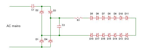

I am making a few LED signs and to save on space and power supplies, i wanted to run them off of 120volts ac.
I know that the set up will be 120 v outlet, diode bridge, capacitor, and roughtly 60 leds depending on color and voltage of that color.
I will need more then 60 leds to do the entire sign. so my questions is where do i split the power to set up additional stings of leds.
Do i need to split it before it hits the diode bridge and converts to dc and just include a second diode bridge
or can i split it after it hits the diode bridge, and just add the 2 or 3 sets i will need with just one diode bridge?
thanks for any help

Here is the basic version of the circuit.
You will need to calculate C1 to supply the correct current for the LED sets based on their total voltage drop and running current and your common line frequency.
R1 can be anywhere from 220 - 1K ohms and C2 should be around 100 uf with a 2x line voltage rating.

For C2 I was planning on using some old disposably camera flash caps. they are rated for 330 volts, and about 80uf
could you supply alittle more info about C1, i wasnt going to include any caps on the mains side of the bridge, but i also dont wana fry leds 60 at a time
thanks
C1 works as the current limiter or ballast capacitor. your LED's wont last very long without it!
To calculate that you need to know what your line voltage is and what your total voltage drop from all the LED's in series is as well.
After that its (line voltage - LED voltage)/ (amps running current.)
The camera flash capacitors will work well and R1 is just to further smooth out the line ripple that C2 does not take out hence the wide variation in its value.
If you are running that many LED's in series you will only need about 100 Oms of impedance provided by C1 at 60 Hz so that works out to around roughly 26.5 uf.
I would recommend breaking that down into sets of 25 - 30 and using multiple strings of LED's.
With two sets of 30 LED's at 2.5 volts you would get 75 volts.
120 - 75 = 45
45 / .025 = 1800
1800 ohms of impedance at 60 Hz would require a 1.5 uf capacitor. Multiple sets could be powered off of the same rectifier and C2 circuit with proportionally larger values of C1.
3 uf would power two strings of 30 LED's at 25 ma each without problems. Just make sure that R1 on all strings are equal.

C1 is key to how the circuit works. Without it I doubt your LED's will last more than a few seconds.
They need limited current and will burn themselves out without a current limiting system in place.
