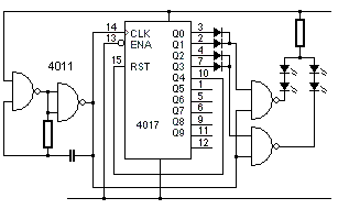

mstecha, i thinking about some similar...
Hi Sebi,
Your blinker circuit is another way to do it but:

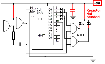

1) A Cmos gates oscillator has an output much closer to a 50-50 square-wave if only one of its inputs is used and the other input is disabled.
2) With a 9V battery, a Cmos gate has an output current into an LED of only about 8mA, so a current limiting resistor isn't needed and the LED won't be very bright without a driver transistor.

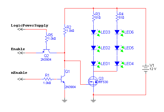

Hooking up the LEDs between the outputs is a "free" way of implementing an "AND" and a "NOT" gate. To implement this discretely, you can use a diode and a pull-up resistor to as an "AND" gate, and a common-emitter NPN to make a "NOT" gate. The output of this discrete gate goes off to a bigger power transistor.
Last time I checked, superflux LEDs maxed out at ~70mA, driving these in series would be pretty easy with most NPN's, or just grab some off the shelf Mosfet if you want to crank out a 700mA pulse.
thanks for the reply there, hjames! yes, the Lumileds Superlux are great little LEDs and i have tonnes of them yellow green, turquoise green, blue and red ones from a scrap dealer! i also have tonnes of red and amber Lumileds I emitters which i have made for off-road 4x4 camp lighting..... i dont know what to do with the other bunch of SnapLEDs though, maybe brake lights? they're called scrap but they work just as well and at a fraction of the cost of new ones! hehe......
being the half-cooked electronics hobbyist that i am, i must ashamedly ask if you might be able to help put this into perspective by letting me know how exactly to connect the diode, pull-up resistor and transistor? a rough schematic or maybe explanation by specifying the where the compnents goes into the pinouts.
thank you very much again for your contribution and help!
This should work - instead of using a diode, I just threw in another transistor hooked up as a level converter. The general idea is that the main switch mosfet (or you can make it a NPN transistor if you want) only turns on if both Q1 and Q2 are off. Now, Q1 is pretty obvious when it turns on, Q2 is a little bit less so, but you should be able to figure that out.
Resize R3/change the number of LEDs in each chain as needed.
