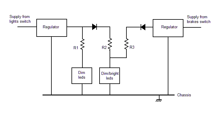

I am making an led taillight for my motorcycle. Here is the way it is setup right now.
what i want is the middle part to light up brighter when the brake is applied and all of it will be lit up less bright otherwise. So i wired the middle sections together as one part and the outers as another, also a few white leds at the bottom for the licences plate.
So this is all fine and dandy...they work when i connect the positive and negative for each section individually..but when i hook them all together...ie..ground wire all together and postives together i get weird results...not working correctly.
i have voltage regulators on each of the power leads one for normal lights and the other for brakes
can anyone tell me what i am doing wrong and how to do this properly....i'm just a newbie
If you connect them in parallel there should be no difference. Could you post a schematic of how you are wiring them?

1) Regulators in parallel without isolating resistors on their outputs.
2) Powering only 1 regulator while the other's output is still connected to it.
3) No input and output capacitors on the regulators for stability.
4) 30 and 100 LEDs wired all in parallel, or maybe paralleled 15 in series with the other paralleled 15, and paralleled 50 in series with the other paralleled 50.
5) No current limiting resistors, just letting the regulators overload and do the current-limiting.
PS, I bet they are 12V regulators with only a 12V (or 13V) input, which doesn't even matter because their output certainly isn't 12V!

okay...all technical info isnt really necessary (led voltage, regulator 7810, resistors), all of that is fine. A person off of my bike forum was making LED taillights without regulators and they pulsed when idling because of fluctuations in voltage, so he added regulators to fix this, i am going by his advice of what to do. But his werent setup like i wanted...I know how to make the whole thing work if i wanted the all of the LEDs to brighten when brakes are applied, but thats not what i am after. Just the center section to light up brighter.
So what i'm starting to understand from this is that both of the outputs are hooked up to the center section that i want....which would work if the one output wasnt also powering the rest of the LEDs. So I need to isolate this somehow?
What about if I branch another power lead off of one of the existing ones and power the outer LEDS and white LEDs with that? will that work or is that still considered sharing a common output?
Yes, you need to isolate the center section of LEDs from the others so that you can change their brightness. You have them all connected together now.

okay so...the leds i have already figured out the necessary resistors etc to use on them...this is not an issue.... the leds are rated at 2.2...i am using a 3.9kohm resistor to make them dimmer and off of the brake light lead i have a 10ohm resisitor(to make them brighter). I tested this on a breadboard with a series of 5...which is what all of them are,series of 5 in parellel. And the regulators are 7810 which require a 12.5V to operate which is fine since the battery will never go below 13V.
Anyways, all of this works fine on the breadboard, so i just need to know how to isolate this correctly and run the rest of the LEDs with power as well without connecting it all together.

This will do what you want.
I m not saying that I think this is the best way to do it, but it's the way with which you are familiar and apparently comfortable.
You seem happy with your values of resistance and cpable of changing them if necessary so I didn't put in any values.
R1 sets the current through, and hence brightness, of the leds whose brightness doesn't change.
R2 sets the "dim" brightness of the leds whose brightness increases with the brakes.
R3 provides additional current to make them brighter.
The diodes isolate the regulators and the set of dim leds.
1A diodes, such as any of the 1N4000 series, will be okay.
I should have said, I realise that R1 and R2 and their associated groups of leds consist of more than one parallel paths.
okay cool....so this is basically what i have already but i need the diodes in there to keep the current from travelling back...correct? Well that seems easy enough then....

You have a nice, simple but very elegant solution. If the LEDs don't draw more than about 25mA each (about 2.5A total), it is perfect.
Yes airbrush, that's right. The diodes protect the regulators from current entering their output pins (from the other regulator). And the left hand one also prevents any additional current flowing through the left hand set of leds when the brakes are applied.
