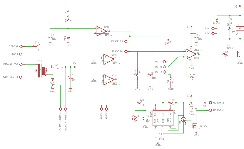

I have designed and built a thermostat for my incubators. It works awesome. Just recently with help from MikeIM i have incorporated a motor control for the egg turner. My next addition is to add a led humidity sensor displayed in a blue 4 number 7 segment and a temperature display in red 4 number 7 segment led. I want to stress " I DO NOT WANT A LCD DISPLAY" I want led because they are viewable from a distance and i like the colors. I would appreciate any help that you could give me. I also don't have a programmer so advise on one that i should have to program multiple types of chips would also be appreciated.
I have attached the schematic for what i am currently using.

actually i am using a 10m on the r7 for now. I am getting a .3 degree hysteresis but i am also getting a relay chatter. Probably a 4 to 5 click chatter. I am waiting for my new resistor assortment to try out a 9.09m to stop the chatter. If i can get .5 degree variance between cycles without the chatter i will do cartwheels in the front yard.
It's a waste of your time posting fuzzy jpegs. We can't read them.
You just have to tell PAINT you want PNG in the drop down menu on the 'save as' window.

Ah, to reduce the relay chatter, R7 should be decreased. This does decrease the precision.
Maybe it would be more stable if you put a 100uF cap from the pot pin 1 to GND.
I could try that. I will build it on the bread tomorrow to see if that will fix it. Problem is that it will work on some boards and not on others.

I put in a 100uf cap in like you said and it didn't fix the issue. i even dropped the value of the r7 to 4.7m and this one specific thermo continues to chatter. All of my other identical circuits works with the original design without chatter. I did have to drop the r7 on one of them to 6.8m to stop the chatter. 6.8m widens my variance to 1.5 degree differance. I assume i would get a much wider valiance if i was forced to use the 4.7m.
Is the voltage across ZD1 stable? Variance there could also cause problems, although the sensor circuit is ratiometric and should be immune to most reference changes. Try the 100µF across ZD1.
Which side of the zener do i try it on?
