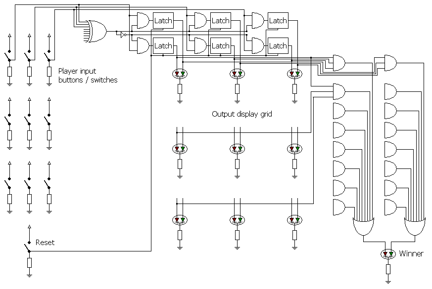

I really need help on this. I have to make a two player tic-tac-toe game using a breadboard and combinational logic etc.....i don't have a clue!

Well, here's the "I'm using the most amount of parts possible, do I win a prize?" approach that -might- work. I haven't done a walkthrough to see if it actually does, but the diagram seems sound. Forgive the MS-Paint. :wink: It should give you a start. AND, OR, XOR, NOT, and Latch. Just some basics. Hopefully you can get some ideas and reduce the million logic gates this is going to take. ^^

Maybe my computer is weird, but why is their nothing attached to almost all the and gates on the right hand side? Is the graphic simply not displaying right for me?

I didn't make a complete image. So yes, those gates do not have any connections displayed on them. The top two show how to determine red or green has three across the top. The next one shows red having 3 in the first column. I didn't feel like taking the time to make the rest of them. If something looks like its missing in the picture, chances are it's just repetitive.
You can use any latch you want. If it doesn't have a reset, you can just turn the unit off and back on I guess. You could construct an S-R latch if you want from more basic gates, or just use a latch you might have in lab. My design uses a non-inverting latch. Although it you aren't using the bi-colored LED like I am, and decided to use individual reds and greens, then you could wire up an inverting latch to the cathodes if you want. It's all just a matter of how you want to do it. I just decided to propogate active high signals.
Sure. This implementation will not work with momentary buttons, only switches or non-momentary buttons. You have 9 input switches, all open. They're connected to the 9 input XOR gate. If an even number of switches are on, it outputs a zero. If an off number are on, one. That determines red player / green player. All of the latches have AND gates at the inputs. If the XOR is outputting a "1", then the top row of AND gates would see a high input for that connection, plus whichever switch you closed gives it another high input, which passes to the latch, and turns on the green LED. On the next turn, when the XOR changes to a 0, the latch allows the LED to stay on. Now that the XOR is outputting a zero, it goes through the inverter, and the bottom row of AND gates sees the high. Whatever switch was just closed gives a positive to its respective AND gate, which goes to the latch, which goes to the red LED. If the top row of three red LEDs are on, that goes into the first 3 input AND gate. Notice there's a huge OR gate those feed into. It's OR'ing up to eight different win states. Any of those turn on the "red wins" indicator. Then there's a reset switch to reset all of the latches. I haven't wired up 100% of the connections. But I'm not getting graded on it. :) You're going to have to use other gates to invent a 9 input X0R and a 9 input OR. Unless you can find a bunch of latches laying around, you'll probably have to build them yourself also. Here's how, with an explanation of how they work: **broken link removed**

Firstly, How many latches are required in your circuit diagram coz from the looks of it i think you need 18 of em....correct me if im wrong:D
Secondly...is the number of AND gates that you have drwan for possible winning combinations enough or am i supposed to add more AND gates....???
