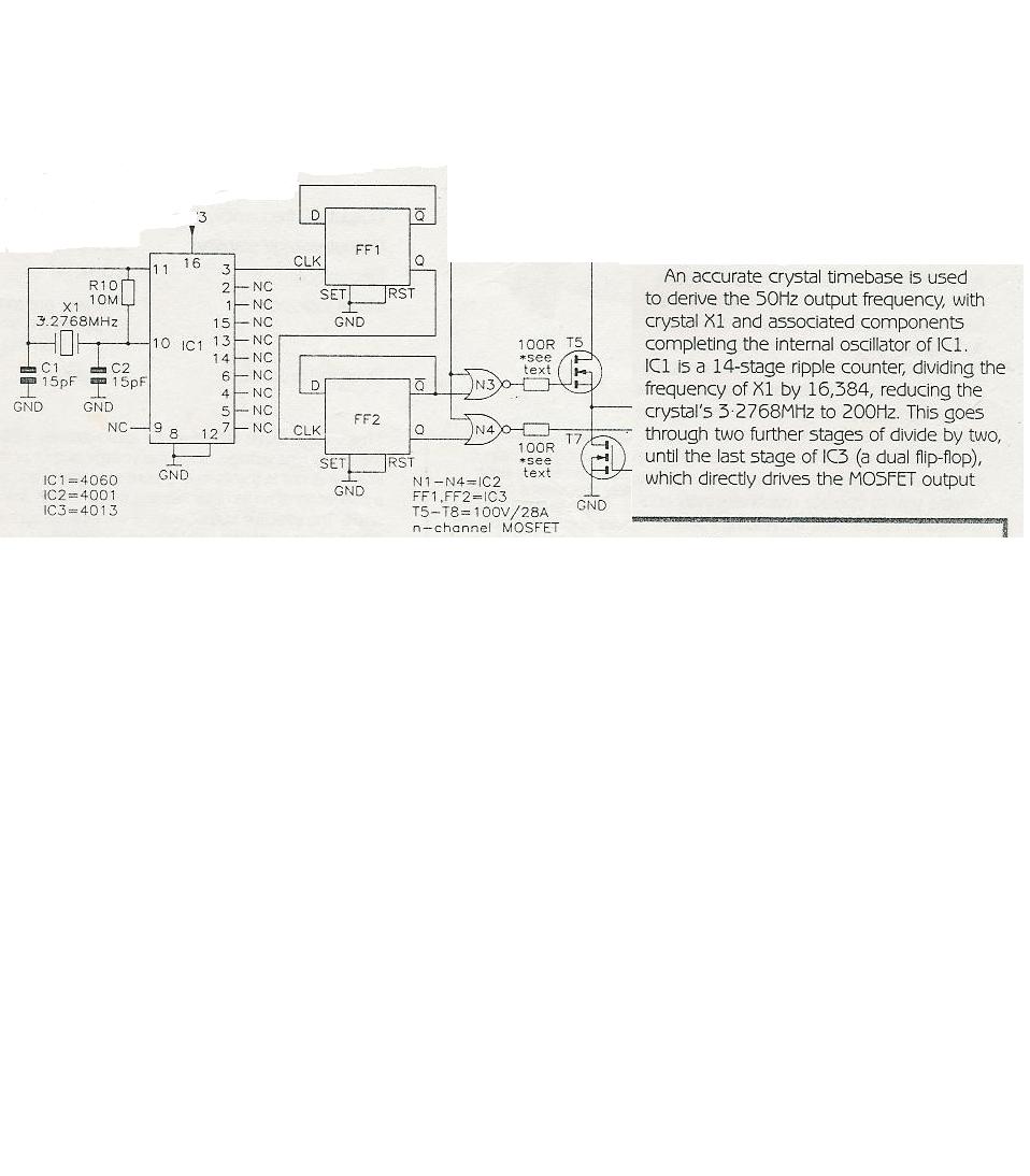

for time base see the attched diagrames, one of them is a part of an inverter that use 50Hz time base, you can use the same oscillator and divider with another extra divider to get required time pulse, 30min etc.

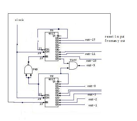

the 2nd attachment shows how you can connect two 4017 counters to get more than 10 lights, you even can make it by three ICs to get 24 stages and reset by the 25th out put.
