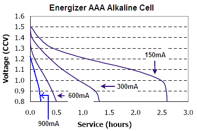

I don't see the point in just adding more LEDs, when it will be more efficient and possibly cheaper to use one high power LED maybe even with a smps current source.
Are you serious about using tiny AAA alkaline cells with a 1A load?
I played with Energizer's graph because they don't show a current so high. I think it is correct:

No , audioguru, I bought one of those torches on trade me (our local Ebay in NZ).
It has 3 AAA batteries in it what i found already under rated for the job.
Now i'm in the process of modifying it to 3 C cells.
The light output is great.
The white LED's run at about 25 mA's each. which is probably a little over for dc operation.
