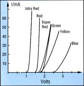

I'm still not sure that you get it. Below is a voltage vs current curve for 6 different types of LEDs. You can see that the voltage is definitely not a linear function of current.
As was pointed out by Oznog, these curves move to the left as LED temperature goes up.

Well, I think I have somehting similar to that super red in the chart you posted. I wish the chart went higher, since I am going to be pulsing these. Looks like 160ma would be somewhere around 2.5V then. That's a big difference from the 1.58V measured on the multimeter.

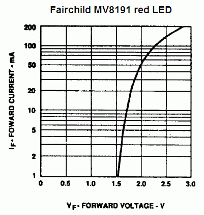

This is the typical forward voltage drop of the very bright red LEDs that I use. The absolute max momentary current rating is 200mA. Notice how the voltage drop isn't a straight line.
